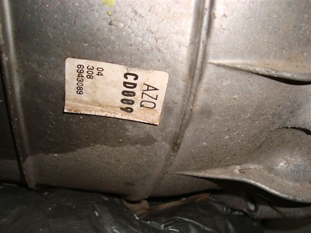

Its a common problem in 03-04's. I had the same problem. Only way to fix it, is to replace it with a cd009 transmission. I did and it shifts like butter compared to the old 03-04 transmissions.

Is the cd009 transmission 05 and up g35'sand 350z's?
all the new 6 speeds are cd009 transmissions. If your buying used, then look for the sticker. There's a sticker on the bottom of the transmission case that saids cd009. Only late model 05's and newer had the cd009. Also the 08 + 350z's has the HR trannies which arent compatible with the older engines.
I would check my350z.com if your looking for a used cd009. I've seen them go for $600-800.
here's a example of the sticker
