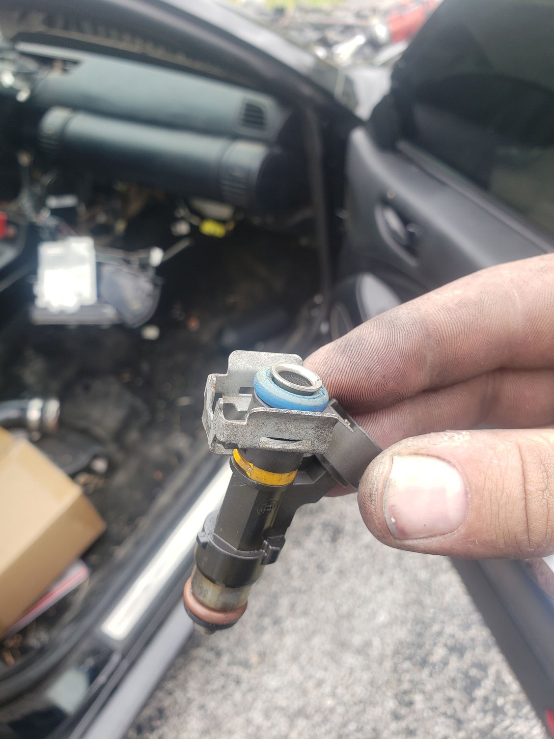

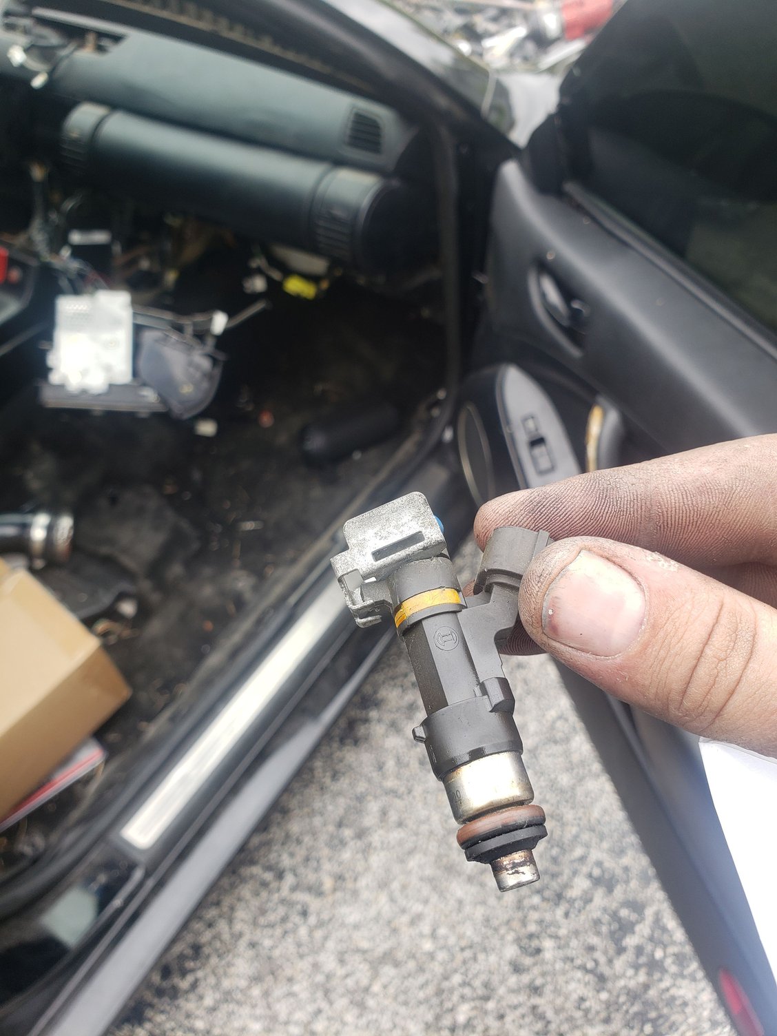

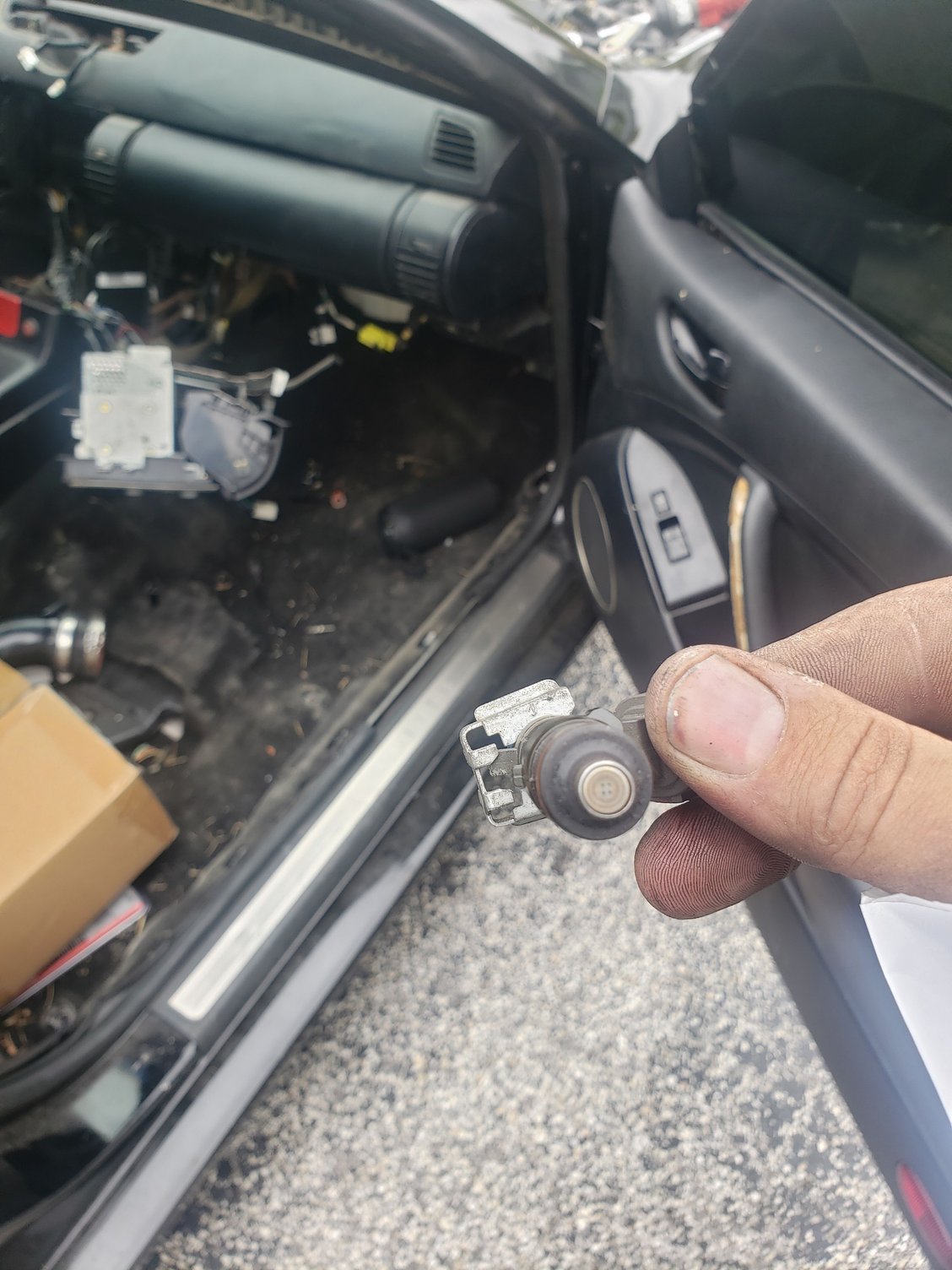

I pulled the injectors i installed from the junkyard and tho they were clean when I put them in they looked just as bad as my original injectors wish I had a pic of when I put them in but here's how they look now
And here's the old Injectors the originals im going to out back in i disconnected the 02 on the drivers side if the car runs fine ill just plug the o2 back in to see if it stays that way I'm also going to do all the factory resets. Update later.

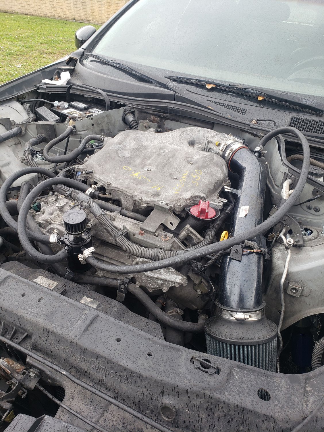

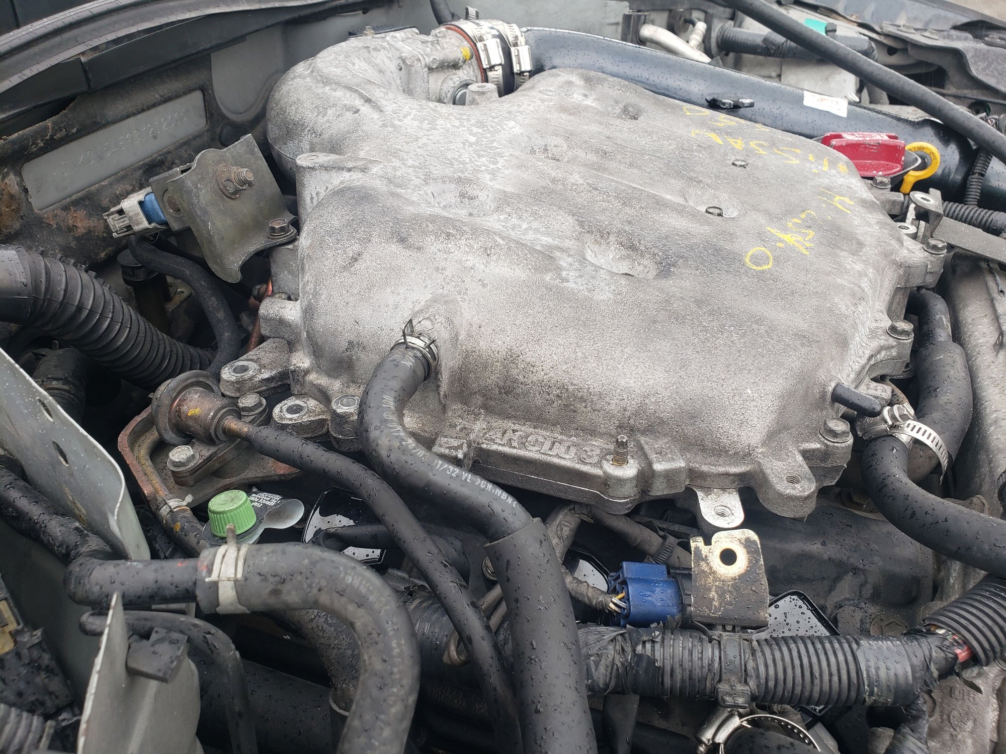

Same damn **** !!! Will a few top plenum bolts missing cause that large of a vaccum ?

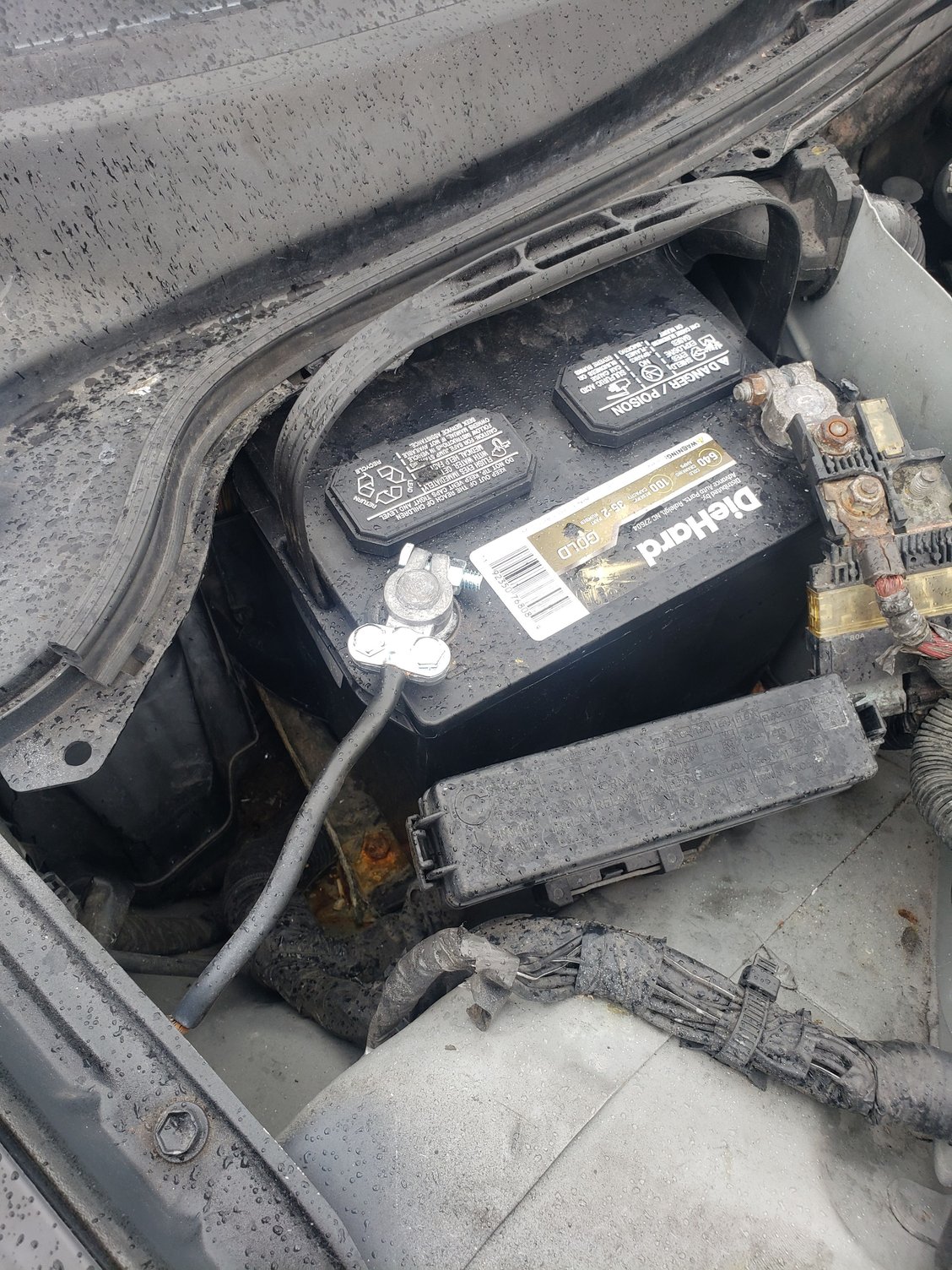

Finished installing my catch can lol but other then that progress is bad... put the old injectors bad in cleaned throttle body with battery terms disconnected had to replace negative anyways heres a pic
Definitely feel like I need some good advice now I know I'm missing a few bolts to the top plenum going around it not in the middle would that cause a big enough vacuum leak? Everything is tightened down.

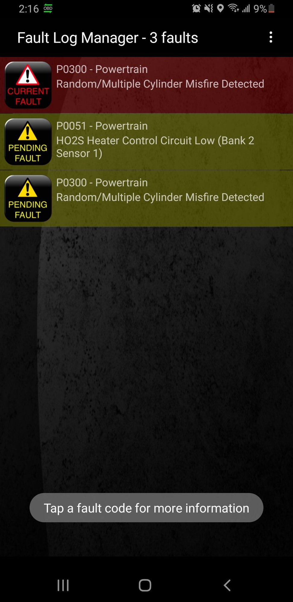

I removed the 02 sensor on the drivers side cat but im still getting the misfire and the 02 sensor code thats all thats showing up heres a screen shot
