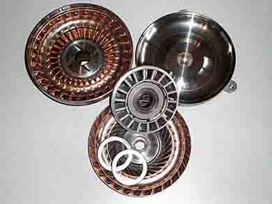

Here's a few of my research notes from an article that was never finished. I believe they're fundamentally correct.
Torque Converter components and functions:
1. The basic components of a modern Torque Converter are the cover, impeller or pump, the stator & sprag and the turbine.
2. The torque converter body is comprised of the cover, impeller & drive hub.
3. The cover is bolted to the engine’s “drive plate” (Nissan’s term). When the engine rotates the torque converter body moves at the same rpm.
4. The impeller “pumps” ATF to stator and turbine.
5. The impeller’s drive hub is mounted through the transmissions front seal and “locks” into the transmissions pump.
6. The turbine is “splined” to the automatic transmission’s input shaft. When the turbine moves the transmission’s input shaft moves.
7. The stator is mounted on a stationary “Stator Support Shaft”.
8. The primary purpose of the stator is to provide initial torque multiplication. WITHOUT THE STATOR A TORQUE CONVERTER IS ONLY A FLUID COUPLING.
9. The stator’s “sprag” is a one way mechanical clutch that allows the stator to work with the turbine during initial acceleration and then spin free.
10. TORQUE MULTIPLICATION OCCURES WHEN THE STATOR IS MOVING SLOWER THAN THE TURBINE. Usually the first 60 feet os so.
Notes from conversation with Andre at Edge Racing 4/16/04:
1. Stator is mounted on a stationary “Stator Support Shaft”.
2. In Park or Neutral - ATF flows from the AT pump (if TC is not 100% full) through the impeller, stationary stator, turbine and back to the impeller.
3. In Park or Neutral - The turbine is “inactive”
4. The torque converter always rotates in the same direction as the engine.
5. The Impeller and Turbine move in opposite directions. Therefore the engine and transmission’s input shaft also move in opposite directions.
6. Most if not all TC’s operate fully “charged” or full of fluid.
7. Power braking is pre-loading the stator.
8. A properly designed stator “cloaks” once the turbine speed exceeds the stator’s speed.
9. What well on the track may not work well on the street.
DaveO
Custom Street Edge TC 11/20/03

TC are upgraded primarily for improving launch but also dictate when/how the engine engages the transmission (i.e. at what rpm will it be directly coupled). So you can alter driveability and drivetrain efficiency as well.
Sometimes you can get the best of all worlds - improve acceleration, driveability and fuel efficiency.
However, the question is whether a better sweet spot can be found on the G35, because I have found that our stock TCs look to have pretty darn good specs. The STR (stall torque ratio) I got from GurgenPB is wrong I think - I read in the 2004 Coupe manual that the ratio is actually 2.0. That's already pretty high. And stall speed is pretty high. So what's left to improve? I have an e-mail sent off to Andre to see if he can answer this question. Will let you know what he says...
