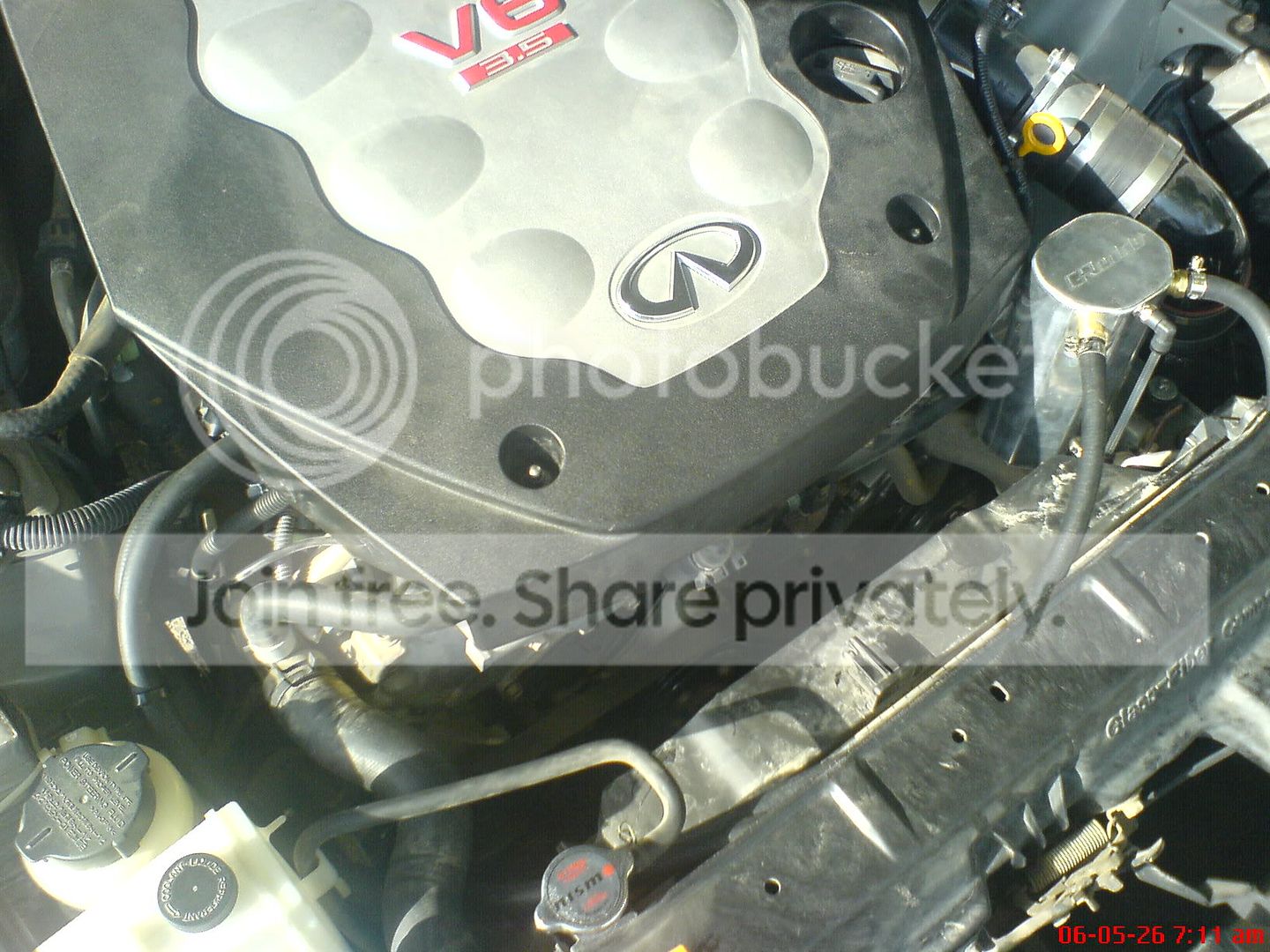

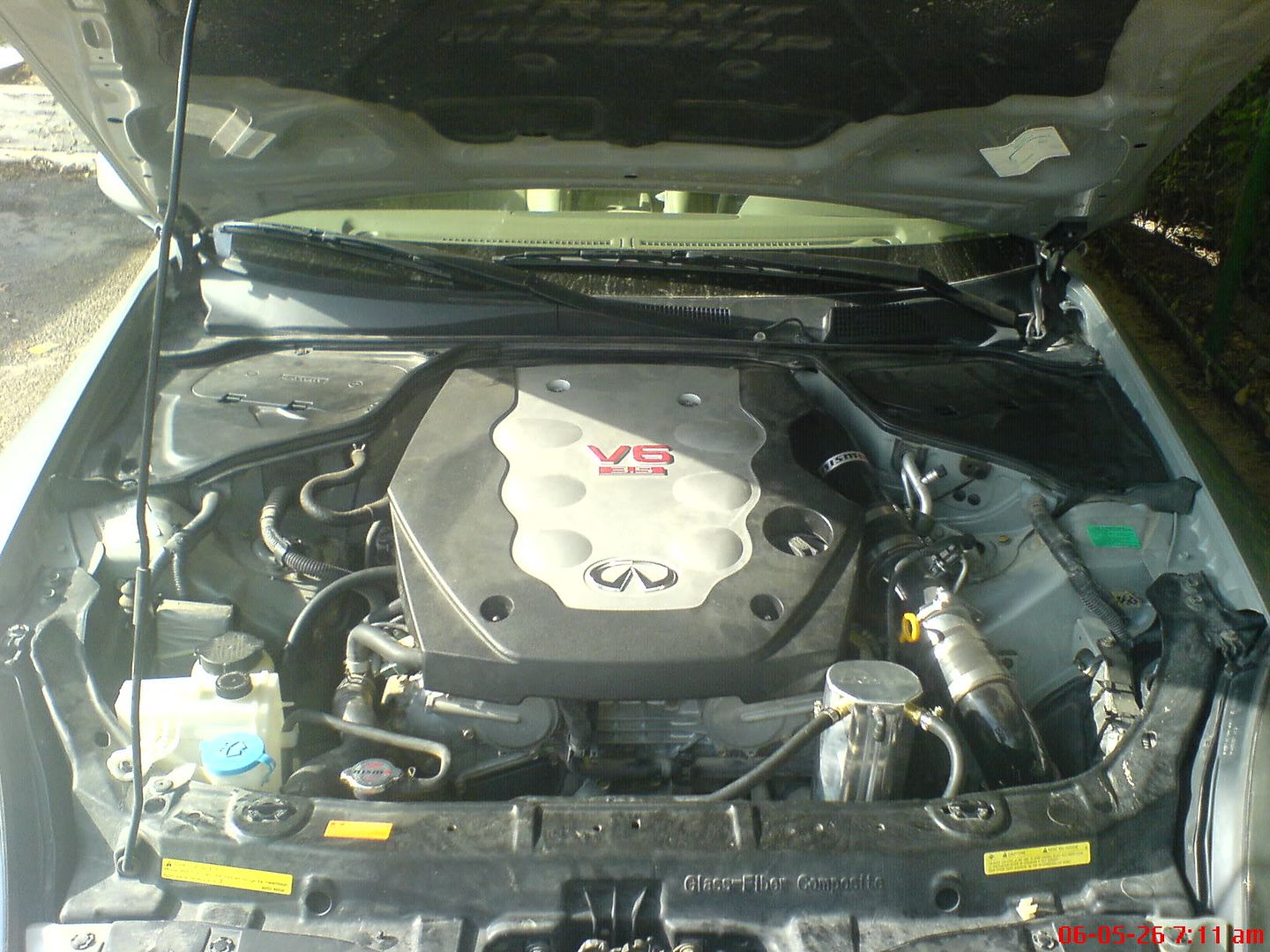

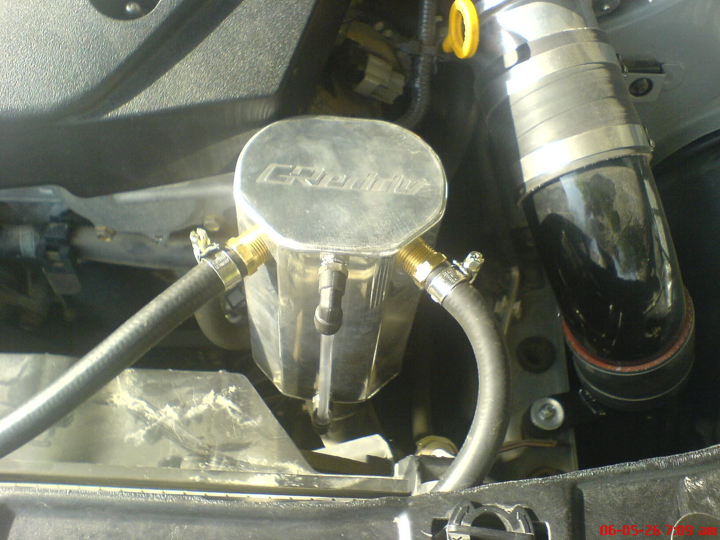

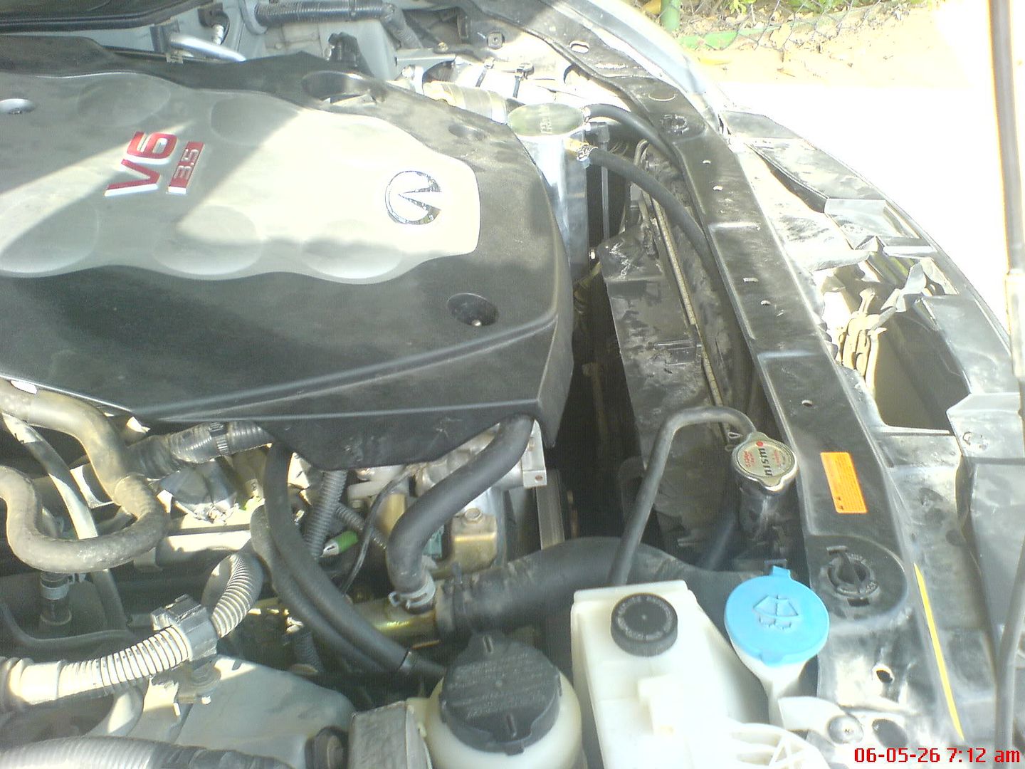

its so easy just follow the instructions here http://www.infinitifx.org/phpBB2/viewtopic.php?t=802 and then locate the place of the PCV hose disconnect it from the plenum side and the PCV valve , connect one side of the catch tank to the PCV valve and the other side to the plenum, and your done
FYI the one i received was with 15 mm hose i should have gotten the one with 9mm because 15mm is too big compared to our 9.5mm PCV valve, both diameters comes with nylon hose with only 1 meter long, its too short because i mounted the catch can near the intake tube side, so you will need 2 3/8 NPT`s and a 3/8 (10mm) hose, use a tough hose like the one used in NOS or fuel applications, bellow is some pictures of my setup.
GReddy Oil Catch Tank installed
http://i67.photobucket.com/albums/h3...K/DSC00168.jpg
http://i67.photobucket.com/albums/h3...K/DSC00169.jpg
http://i67.photobucket.com/albums/h3...K/DSC00171.jpg
