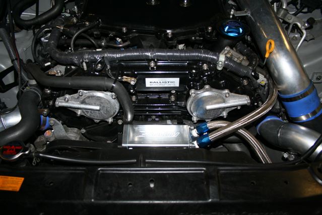

Is that a catch can, or are you just happy to see me?
Greddy rectangular catch can mounted in front of engine I know there's been a few questions lately on where to mount them so I thought I'd share. Sorry I'm not ballar enough to afford ARC
Attached Thumbnails Is that a catch can, or are you just happy to see me?-img_5779.jpg

Nice engine bat. has it have any conflicts with anything near it ???
like what?

So does the catch can get the crap from the BOV?? Can someone explain how it supposed to work?
it collects oil and blow-by gasses from the intake
Edit: Here's a pretty good blurb
The catch can acts as a reservoir for the oil blown out of the outlets of the tappet cover. Instead of being tapped back into the intercooler piping before the turbo, and also directly into the plenum as is standard procedure, the 2 lines both run into the catch can.
Any oil that comes out of these lines then is trapped in the can, with no oil being recirculated back where it isn't needed. Every few months its a simple matter of letting the excess oil drain from the drain plug at the bottom of the can. Alternately you can run a line back down to the sump to let the oil drain down there automatically.
This avoids the common problem of oil all through the intercooler piping, intercooler plenum and vacuum lines, and ensures that only clean air is circulated in these areas and eventually burnt in the motor.

What do you have on the passenger side pcv? Not much comes out of the driver side.

How is that mounted???

Gotcha...so it's an FI thing. Guess I'll need to add that to the list

If you are not FI, do you still need a catch can?

Blow by happens FI or NA. Some of the dirtiest plenums I've seen are rev ups.
The PCV valve on the passenger side is a one way valve going to the lower collector. Read this sticky. https://g35driver.com/forums/engine-drivetrain-forced-induction/97390-makeshift-oil-catch-can.html
