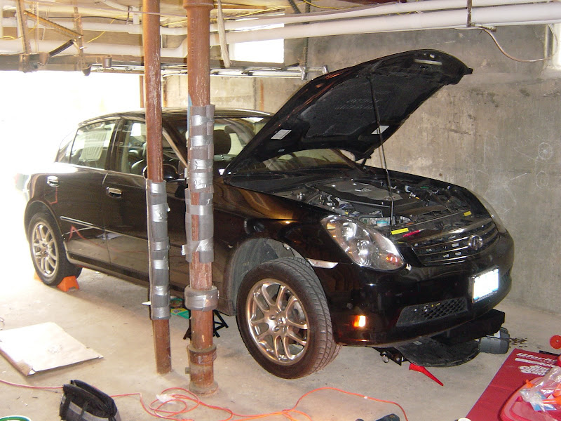

I would like to give a shout out to bythabay for his DIY videos. Thanks!!! Finally, did my first coolant and atf drain/refill. My G is an 05 with 30k miles.
Impressions:

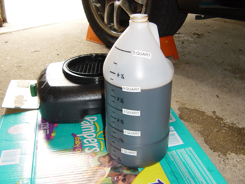

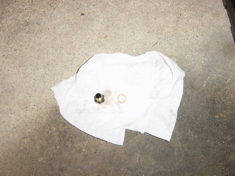

1) Surprised that I could of done the ATF without lifting the car. The bolt was reachable with a long stretch of my arm. I actually did it by lifting though since having a pan underneath it would limit the mess but I might think about not lifting car next time. It's a pain to lift the front end I think. It drained out exactly 4 qts. In two months, when I do my next oil change, I'll drain another 4 quarts of the ATF.

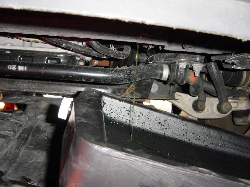

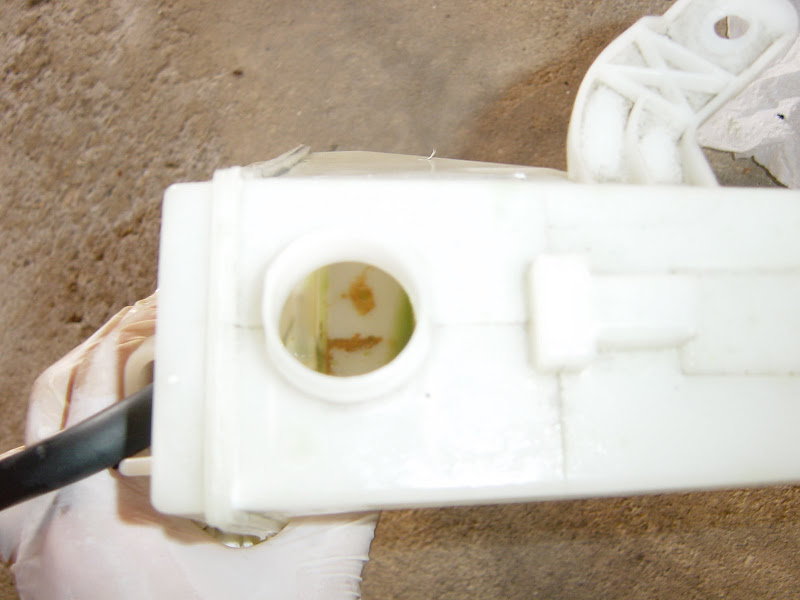

2) I removed the underbody shield to do the coolant. Next time, I might try doing it without even lifting the car or taking out the shield. There's a hole right under the coolant drain plug. Waiting for the air pocket to burp out took forever. Must of driven a good 30 minutes or more and stopping, starting and revving the rpm. Found out afterward that some rev it at an incline or hill and supposedly that helps.
