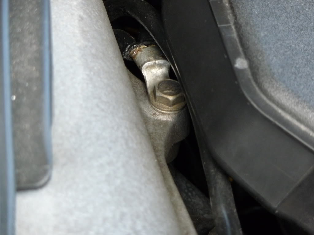

check the coil gounds on 05-06 they are high up right uder the cover on the front of the block

I have an multimeter and a 06 manual tells me where everything is my bad on not knowing you have an 03 the wiring will be different, search the forum i got it there might take a while but you'll know 4 sure. 2nd option get, borrow a multimeter take a coil pack plug off and check (all 3 wieres to ground) 1 will be ground, if it reads high ohms even 5 ohms U found your problem. I have made mine perfect and omg acceleration. Clean the bolt with NAPA QD cleaner and bolt hole to with nQ-tip let me know what U did

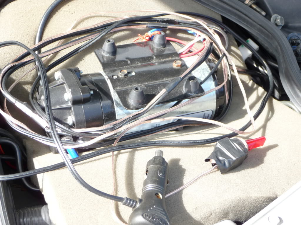

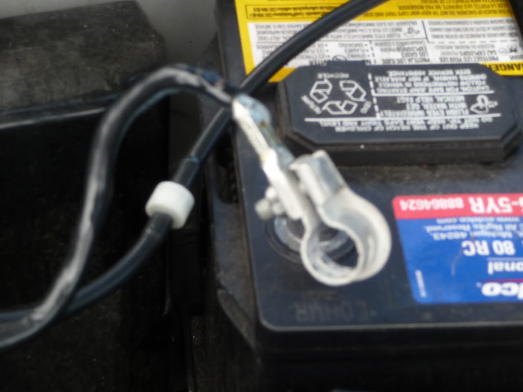

I'll show U my 06 g35X coil and 2 transmission ground pointsName:  P1000176.jpg
Size:  52.8 KB solder everything Name:  P1000182.jpg
Size:  66.2 KB Name:  P1000181.jpg
Size:  69.2 KB Name:  P1000180.jpg
Size:  60.2 KB Name:  P1000179.jpg
Size:  129.1 KB Name:  P1000175.jpg
Size:  48.1 KB Name:  P1000173-1.jpg
Size:  55.8 KB Name:  P1000170.jpg
Size:  47.6 KB Name:  P1000171.jpg
Size:  46.8 KB This is the cure every problem my car had except 4 1, the carbon is done with water injection not enough pics yet i will show U the pump. Name:  P1000186.jpg
Size:  170.0 KB this is an RV 12V pump 250 psi and a 1 GPH (gallons per hour) nozzle on an NA G35X. this will keep U thinking 4 a while.really gonna like this 1 Name:  P1000183.jpg

Reason for grounding tranny?
Old May 1, 2012 | 02:55 PM
  #43
wiredG35's Avatar
Joined: Jul 2011
Posts: 31
To eliminate manual mode lag in up-shifting, but still auto kicks *** on manual and holds it in gear for a few seconds when hard driving. I can do 0-60 in 5 sec with these mods. Trying 2 share for those who don't want FI and the money it costs.
