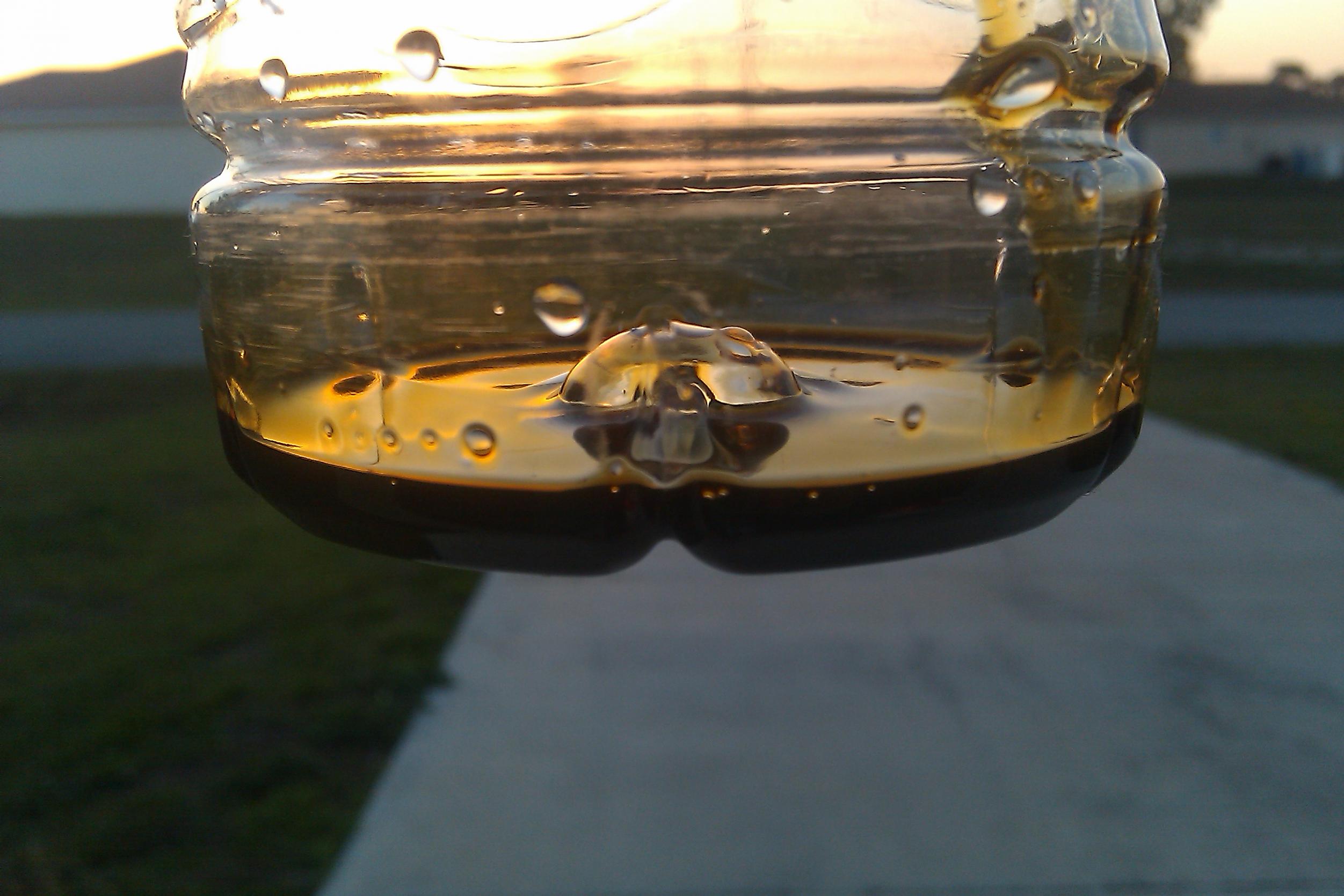

Finally got around to installing oil catch can. After letting it idle to check for leaks then a trip around the block this is how much oil was in the reservoir. I poured into a water bottle because the husky reservoir was over half full. Is this alot of oil?

Old Feb 19, 2011 | 06:44 PM
kennymo's Avatar
Joined: Sep 2009
Posts: 3,205
Likes: 23
From: bay area
you had that much oil just from driving it around the block and letting it idle for a couple minutes? something is definatly wrong
Old Feb 19, 2011 | 07:05 PM
Cox_G35's Avatar
Joined: Dec 2010
Posts: 41
From: Cape Coral, FL
But what could it be. Could it be just build up cause the oil couldnt go anywhere cause the filter that was on it. Im going to go get some food then check it again when i get home. If it has that much again i may be in the market for a new g.
Old Feb 20, 2011 | 11:33 AM
Cox_G35's Avatar
Joined: Dec 2010
Posts: 41
I drove 2.5 miles then checked the filter again and it was over half full again. I went to the gas station for gas and was wondering if i was burning it threw the exhaust. I took a little video of it.
