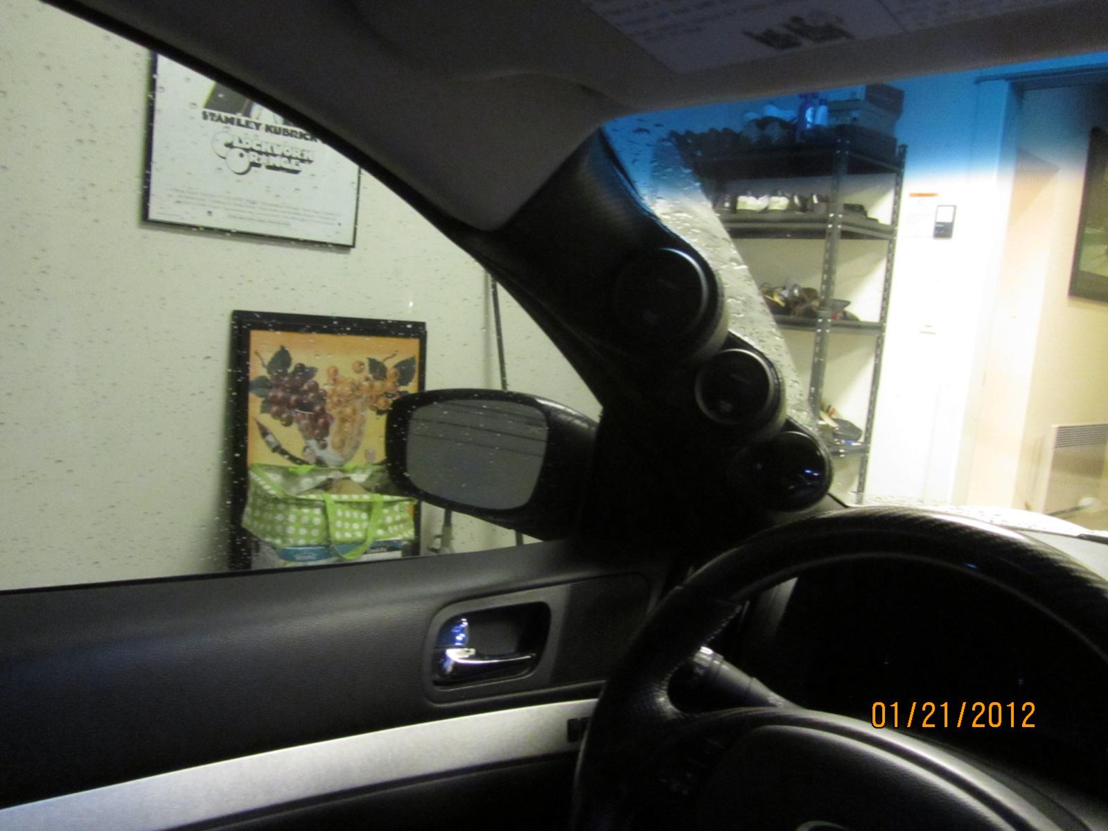

Driver Pillar Molded And Wrapped In Perforated Leather And Passenger Too

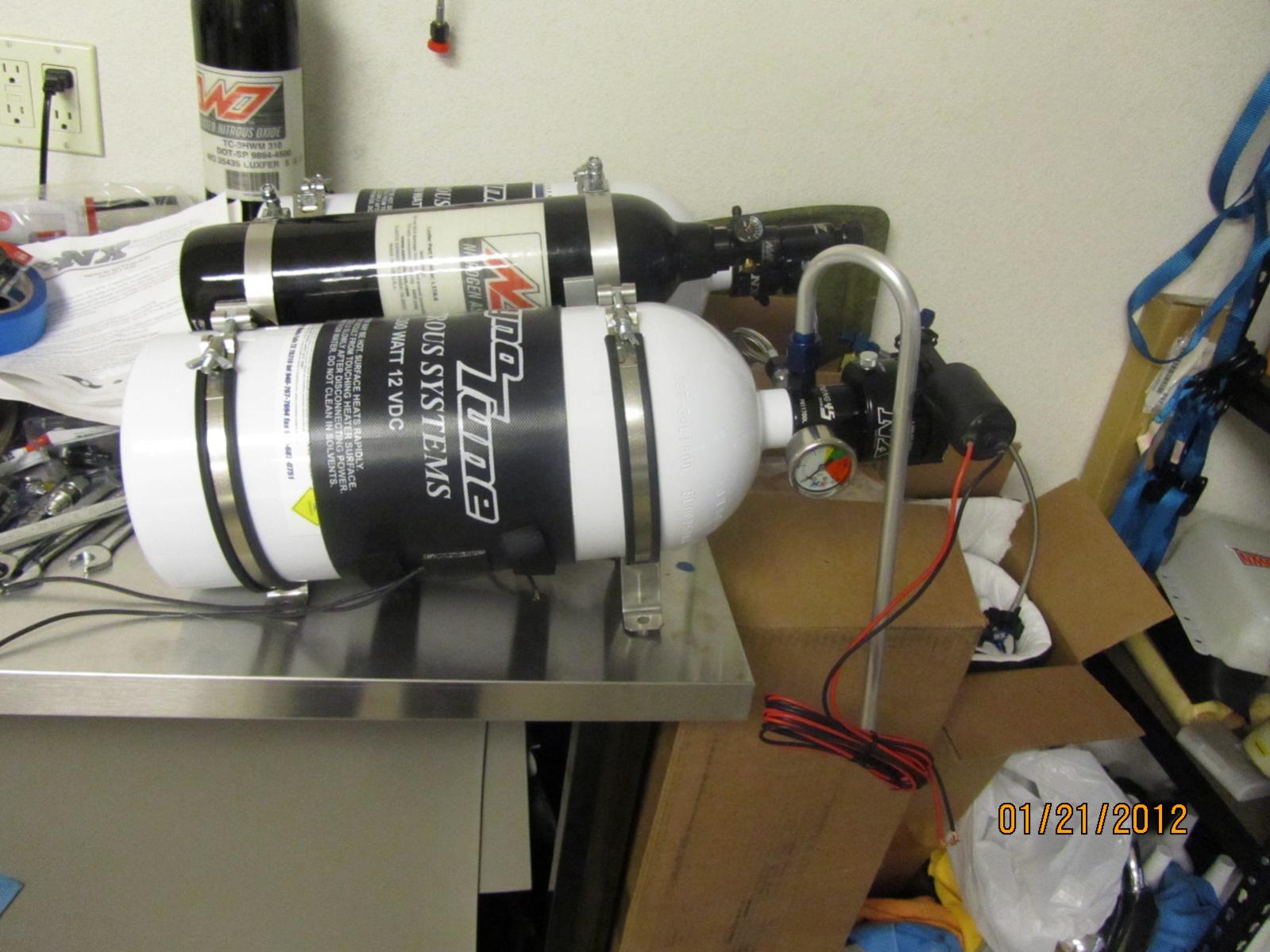

Here is some pics Showing How the bottles will look .. Has all the goodies including blow down tubes as well .. Will Update with pics ...Enjoy !!!!!
Attached Thumbnails Nitrous 150 Shot build-img_1969.jpg   Nitrous 150 Shot build-img_1970.jpg   Nitrous 150 Shot build-img_1971.jpg   Nitrous 150 Shot build-img_1972.jpg   Nitrous 150 Shot build-img_1973.jpg

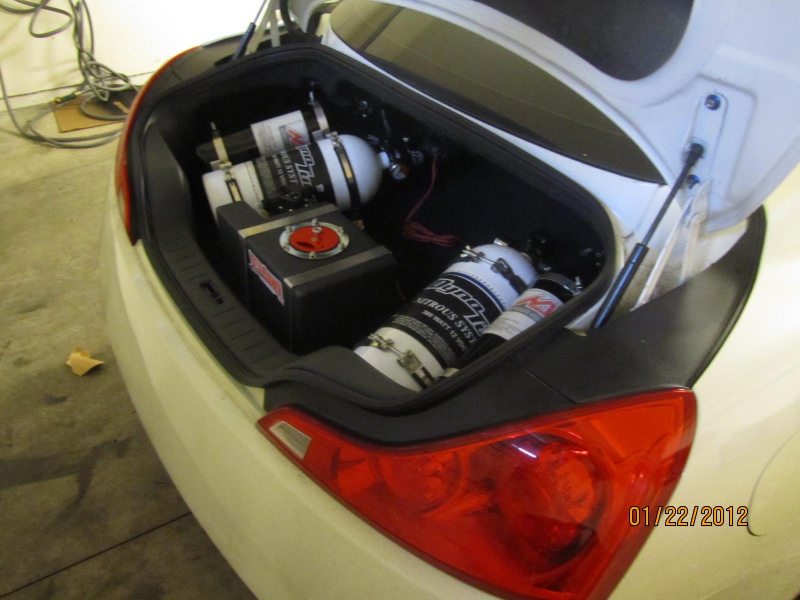

Here is how everything will look like in the trunk .....
Attached Thumbnails Nitrous 150 Shot build-img_1982.jpg   Nitrous 150 Shot build-img_1983.jpg   Nitrous 150 Shot build-img_1984.jpg

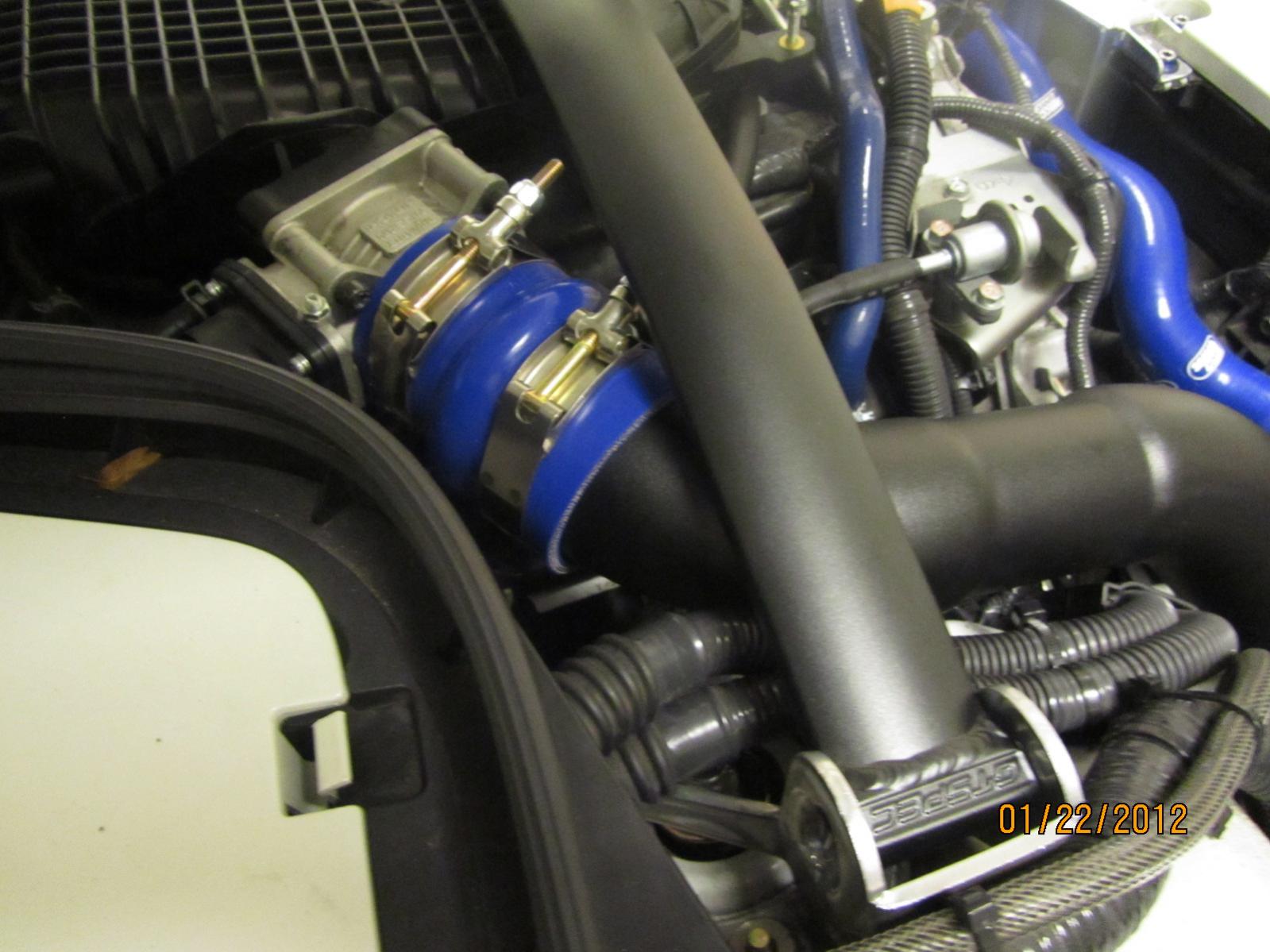

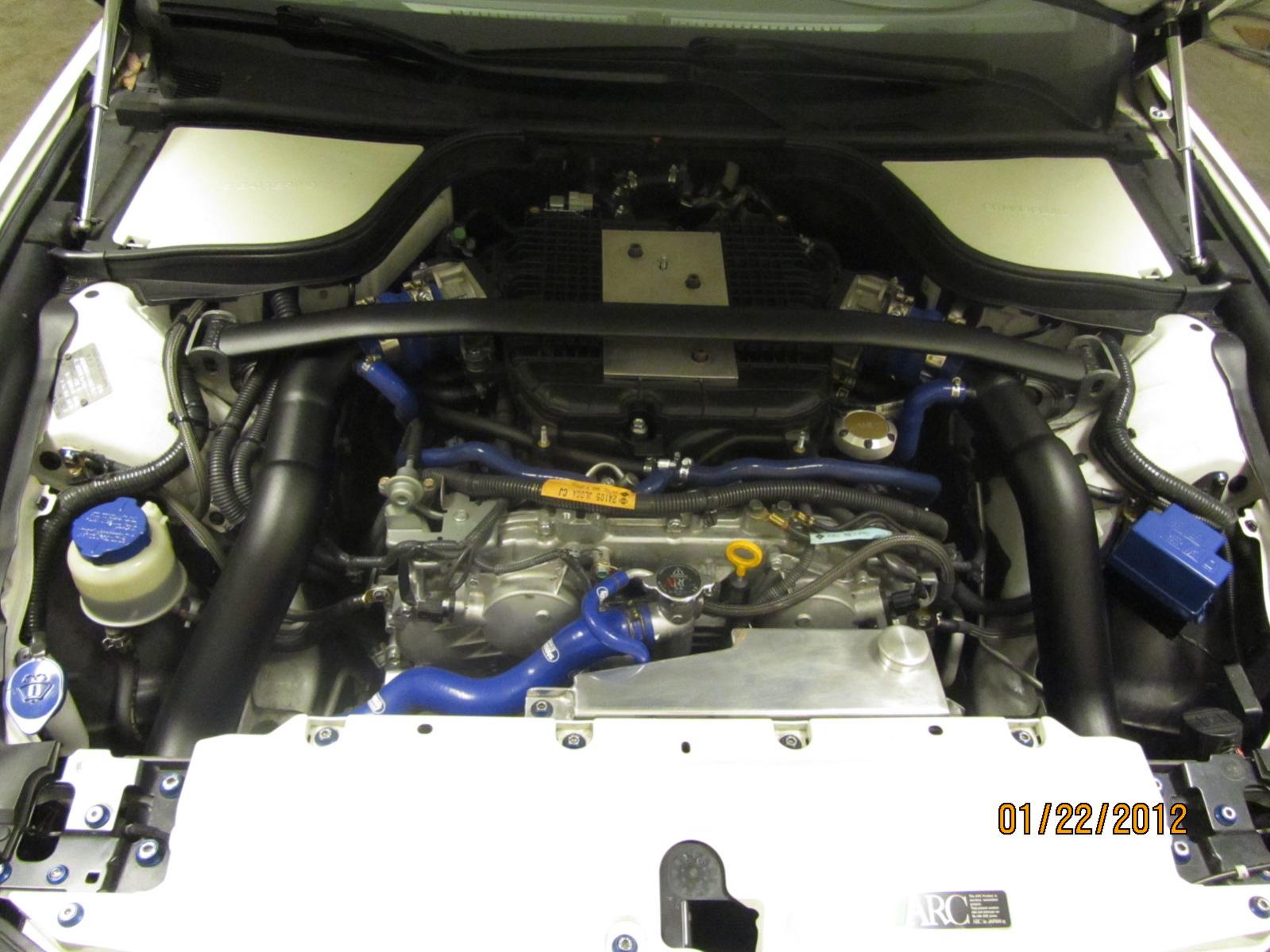

Now I am moving on to the issue of nozzle placement ... Not a whole lot of room for Meth and N20 nozzles .. One of things that sucks about my Takeda intakes is the lack of room between the throttle and MAF sensor.. Pics are to show what I am up against .. The engine cover and strut bar will be on when I am done .. Strut is there for Nozzle placement ....
Attached Thumbnails Nitrous 150 Shot build-img_1985.jpg   Nitrous 150 Shot build-img_1981.jpg   Nitrous 150 Shot build-img_1978.jpg   Nitrous 150 Shot build-img_1979.jpg   Nitrous 150 Shot build-img_1980.jpg

love the trunk dude! i just put a 10lb bottle and 3000psi nano system in the trunk of my g35 and i thought it was getting crowded. you've got a serious setup there my friend!
