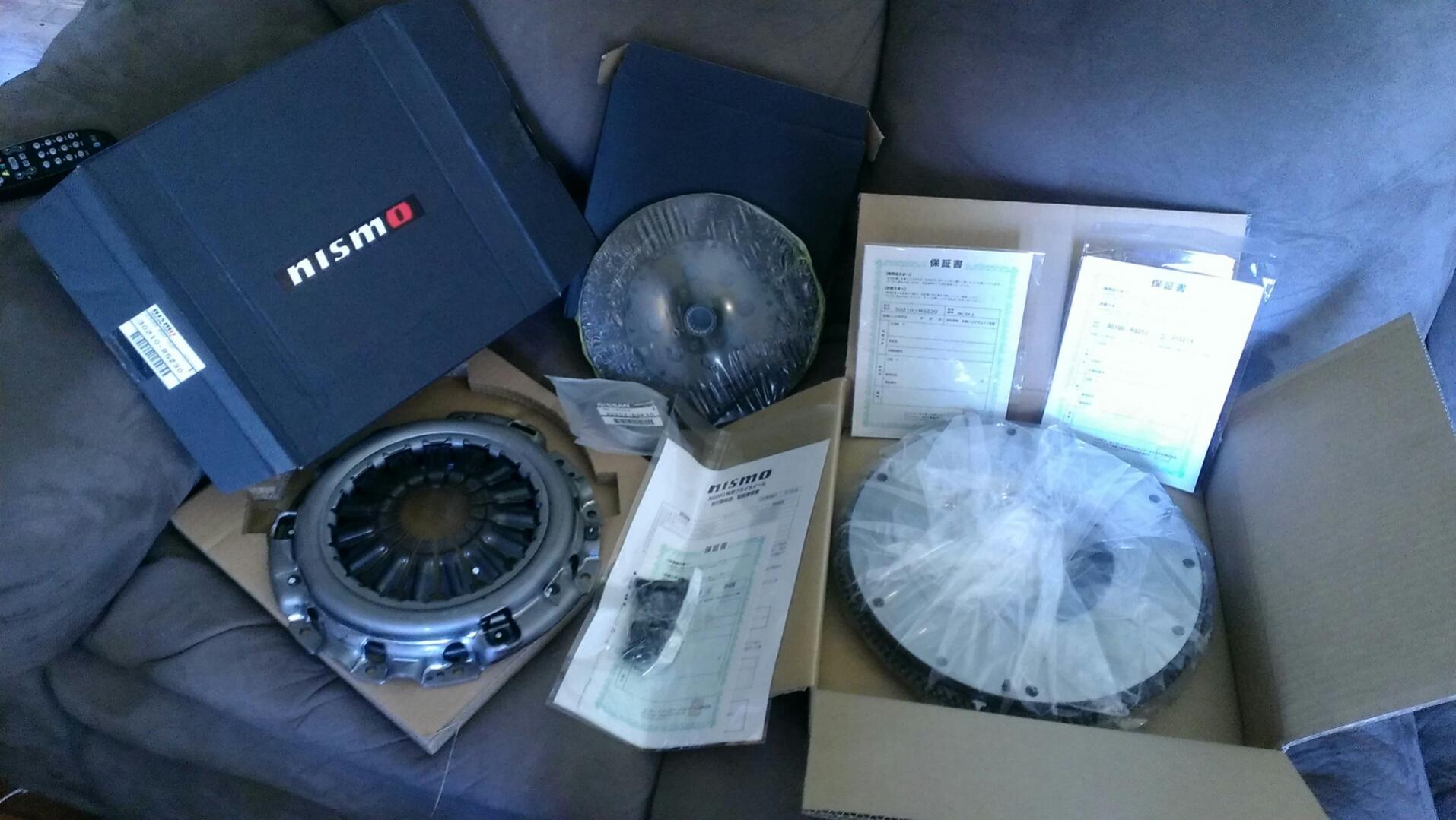

FVCK YEAH....Worked out. I have the whole NISMO set up with a coppermix press plate. I'm waiting on Concept Z for NISMO motor mounts, an Avid trans mounts, a Koyo bearing and I'm going to see how their needle bushing (grooves on the inside that the shaft fits in) works as opposed to the smooth stock one. I should have everything next week and ill post up pics when I do the install.

actual picture this time....

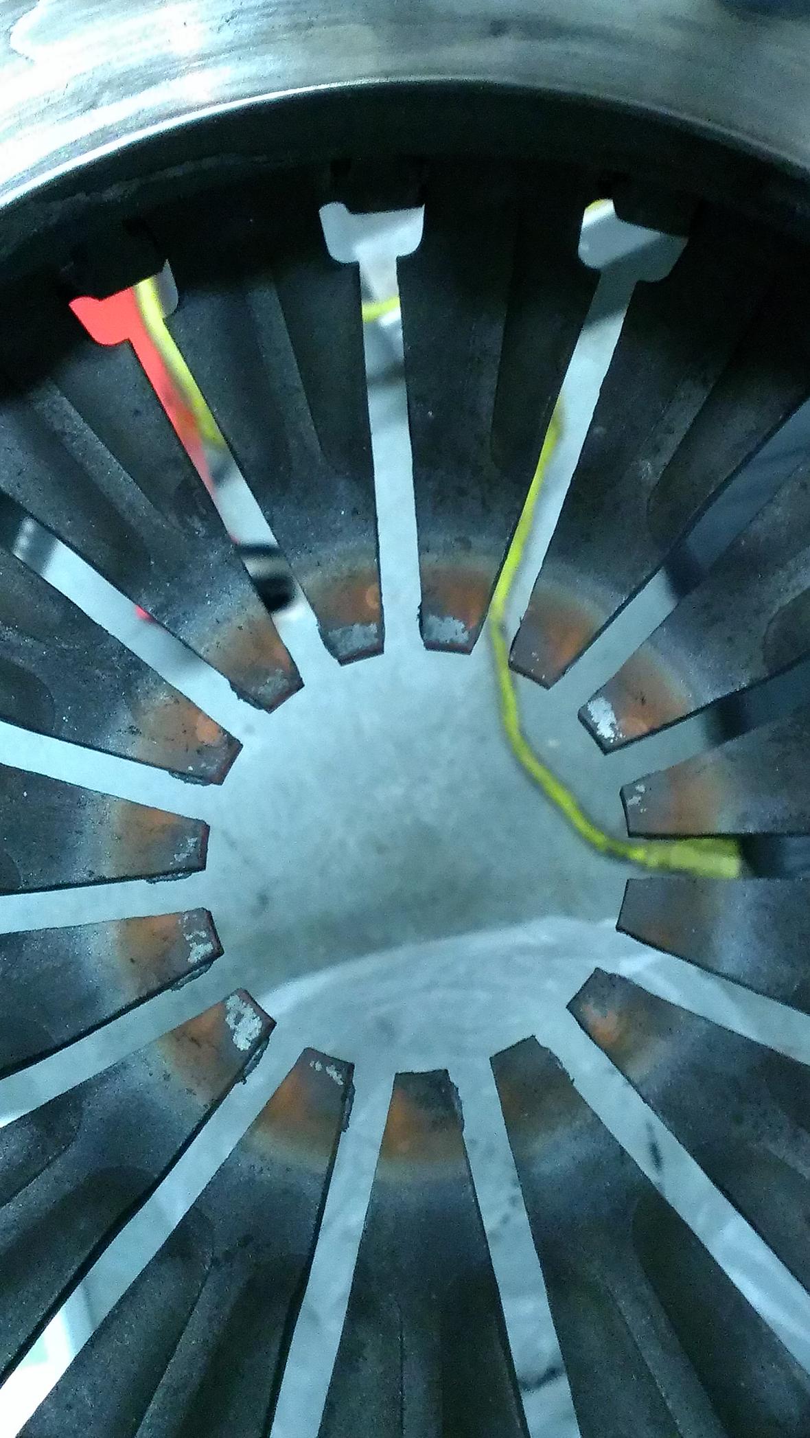

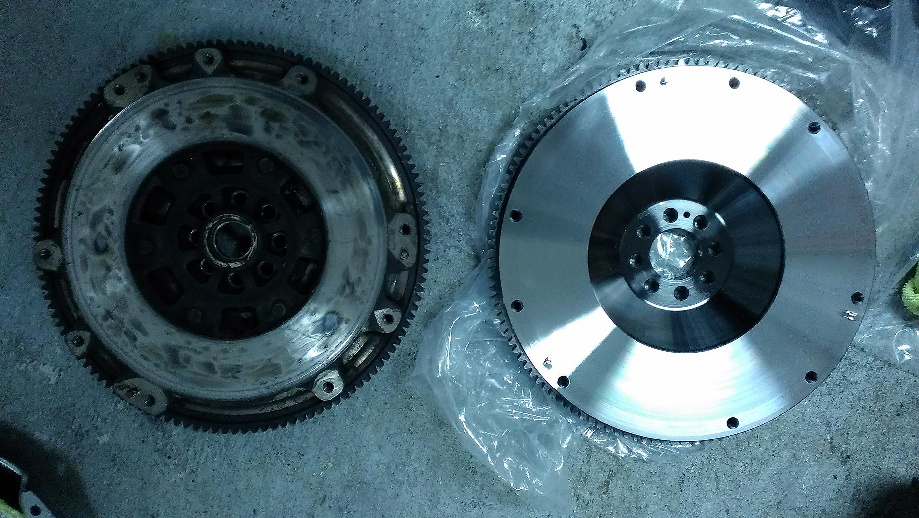

coming along slowly.....suspension is done (shocks/springs/sway bush/end links/new mounts) and I deleted the mid muffler and had a pipe welded in its place. KYB bump stops needed some sanding to fit, the bell housing bolts each popped like a .22 going off, and the driveshaft had to come out. Also the flywheel bolts were T55, not T50. Dropped the trans knowing I needed a TO bearing but I also needed a the sleeve it sits on since the bearing was so f*cked up. $27 part; no big deal. Wilwood master clutch cylinder and Centric slave are on, NISMO clutch set up is on, but the driveshaft, exhaust, trans are next to my car. I need to do this whole "work" thing to fund this operation so I wont be done until next week. Here's a couple of pictures, the flickr link has the rest.
