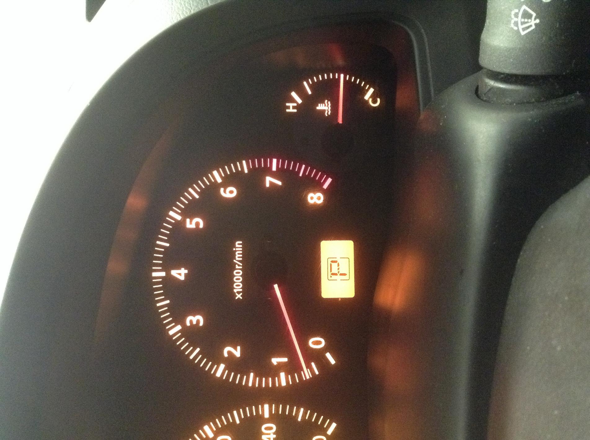

Ok. I attached a quick snap shot of the rpm
I've been doing the relearn procedure I just don't know if I have been successful because the rpms are still the same. I called MD and spoke to Tony and he said that the calibration for the throttle is probably messed up so to keep trying the reset and it should go back to around 600-700.

There was another thread and he had to drive 100 miles before everything went back to normal. Just not sure if he had a high idle. Next question, are you sure there are no vacuum leaks?

No, my idle never went back to normal. Its still at the first little line (200-250rpm), but idgaf, its not hurting anything. Mine doesn't dip down into struggle mode like OPs tho.
Also mine was doing that before the spacer. Mine started after I cleaned the tb. Did you touch the tb butterfly, op?

I'm pretty sure there isn't any type of vacuum leaks. I just checked while the car was running

Yeah my kinda does that dip like it's struggling to turn on. I went to town yesterday to go to the movies and as I was leaving the car didn't have an issue starting.
I was very careful with the tb. Unless the guy I had helping me did. He was handling the throttle body more when installing the copper piece.

I would check the little rubber ring around the oil filler cap. Mine got stuck in the plenum a bit and caused a rough idle. Just yank it out with pliers if you can.

Pretty much the same thing happened w/ mine when a 5/16 spacer was installed by a shop. Soon after I got a Mrev 2 and decided to put it on myself. I was a tech for about 7 years so I thought it would be fun to do the install and it was. This install can be done by anyone, even a beginner. Anyways the install from a shop I think one of the gaskets had a minor leak in it cuz it was bent back a little that I found when I took off the upper peice. When I did the install myself, I made sure to torque down everything to spec and made sure the gasket were correctly aligned and this fixed the problem. You should take off and redo your spacer and get a "Torque wrench" follow the guide lines Motordyne has for you to do and torque down all the bolts to the correct setting w/ the torque wrench (which should be about 100 in lbs of torque on most of em). You might have a minor leak from a gasket or from not tightening down to the right spec so u could have leakage from anywhere on your install. Redo the process and take your time it should fix it.
