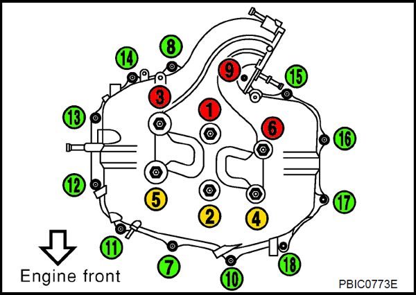

Let me start by saying I am not very knowledge about cars and this was one of my first mods other then exhaust.
So I put on my Z1 plenum spacer today and everything went pretty smoothly I think, the reason I say that is because there were three bolts that I don't know if fit properly. I had to use 3 OEM bolts that were M6 x 25 MM bolts. They never tightened all the way. I don't know if the bolt isn't long enough or what. They keep turning and never fully tightens. I turned on the car but I everything ran fine. Idle was good. I went for a test drive and everything was good. I even went to red line for 1st and 2nd gear (not sure if that was even a good test) and checked for a leak after but I didn't hear or feel anything weird. I guess my question is, does everyone had this experience with their install? Is this just how it is?

Is it possible you stripped the threads or left off three of the plastic spacers? Which bolts are they?
maybe? When I tried to tighten them first I felt it getting a little tighter but after a point it didn't feel like it was tightening anymore. They don't feel loose when I felt them. They were bolts 14, 8, and 15. The instructions told me to reuse OEM M6 x 25 MM bolts which I did.

Motordyne kit I got had all new bolts. At some points if those bolts didn't fully tighten, you're going to get a vacuum leak. Might want to see if you can find some slightly longer to make sure they are fully seated.
