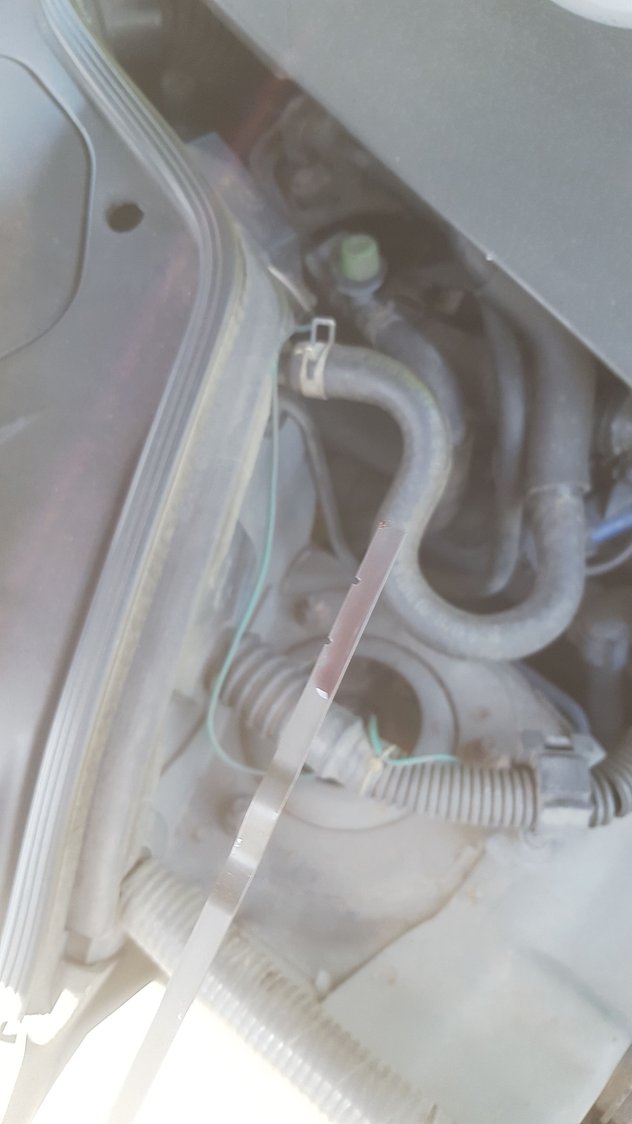

As the title stated, I'm not sure if I should replace or add ATF to my G soon. Its at 97K miles right now. I just feel so paranoid because everytime I start my car, I see the "AT Check" Light then goes away. (I heard this is just to check if systems work) But either way it makes me feel nervous.
If I do need ro replace it, what kind of ATF should I get and how many QT?
Heres my ATF Dipstick

Fluid color looks fine. I know on the Honda boards Redline D4 is preferred over Honda OEM fluid but you should make sure its compatible with Nissan automatics first. Any quality Nissan equivalent ATF fluid should be fine.

The light is normal if it stays on for an extended period. Your color looks good as well it's nice and reddish. If it was black, brown, smelled funny, and/or gritty then I think you should start worrying.

Thanks everyone, I feel safe now
