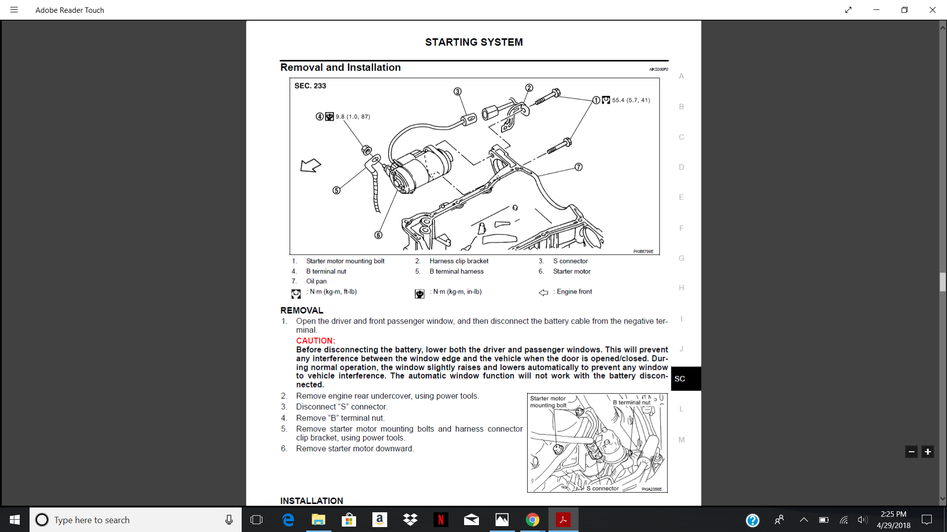

there are 2 bolts that i took out, 2 of 14mm and a 12mm. is there anything else i need to do? the starter won't come out, i gave it a lot of moving, pounding, prying, etc. starter still would not come loose.

Screenshot of the FSM for an 06 coupe.

I hope I'm just being an idiot. I put the two 14mm bolts back so you can see

I think I remember bolts being physically on the starter you have to remove.
that's what i'm wondering all this time but that's not what the manuals or DIY around the web is saying.

Those are the ones, top one has the harness bracket, bottom one just screws into the starter. So youre saying you took both those bolts COMPLETELY out and the starter still won't pop out??

Call me crazy but looking at your picture I see another bolt at the top, kind of blurry in the background, that appears to be in the same part of the housing that the other two bolts are in. If that's so it would need to come as well I would think.
