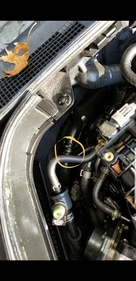

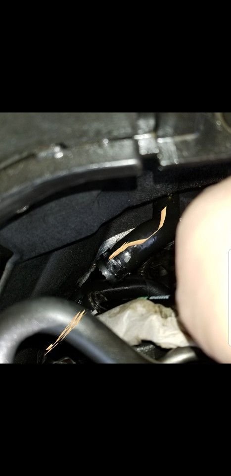

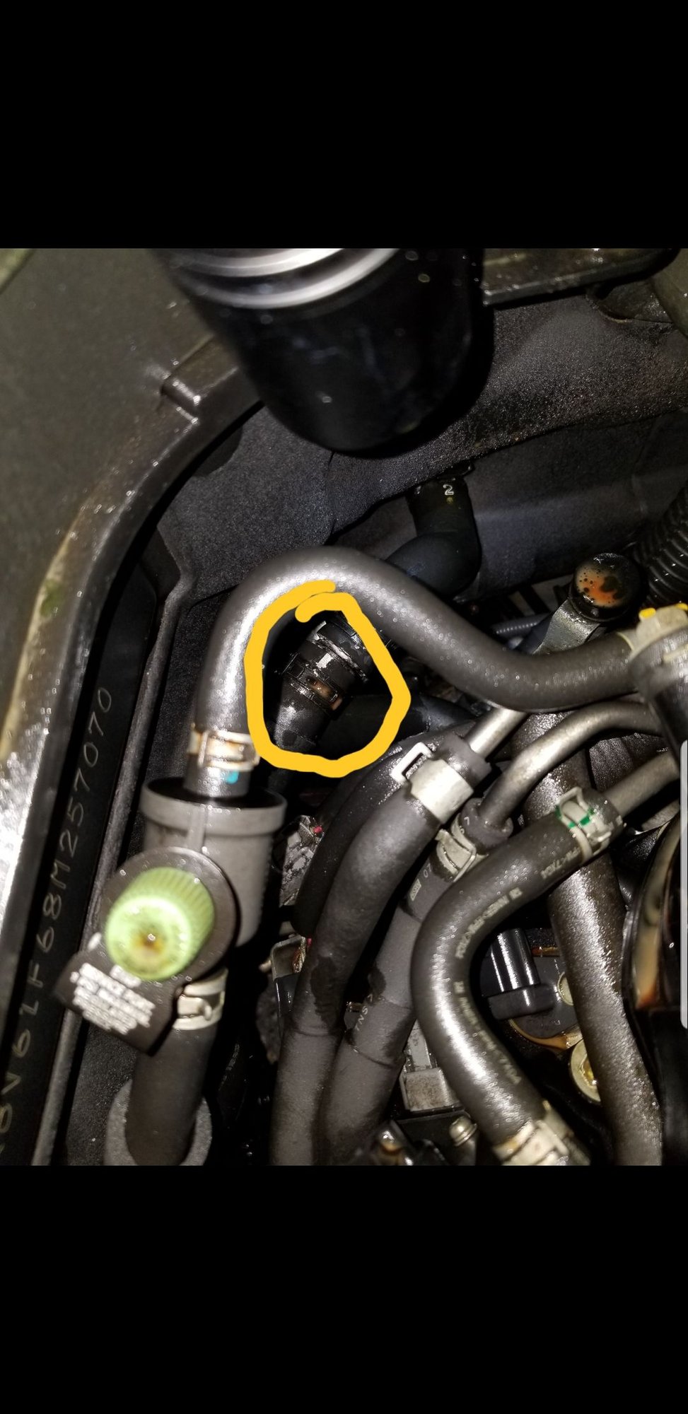

Car is 2008 G35X Sedan. 105K miles.
I was driving and the temperature on the car went really high so I'm assuming my coolant leaked. Then all of a sudden, heard a burst sound and smoke started coming out of the engine.
When I looked under the hood, I saw that one of the hose was broken. I don't know what this hose is but I see some liquid all over the area which I think is the coolant. Color was brown (assuming from rust).
Anybody know what this hose is? It was connecting into the car (maybe connecting into the AC)?
This is on the left side of the engine. I saw the same type of hose on the right side of the engine as well. Has a small number "2" written on hose that broke. The right side hose has a number "7".
Can anyone help?
Thanks

Can't say for sure about the '08s but that looks a lot like the coolant bleed valve on the heater hose for the 1st generation cars. They're known to crack just like that.
Good time to replace that (z1 has a metal version), flush out all the rusty old coolant with water, and then change your thermostat and coolant temp sensor before refilling with 50/50 coolant/DI water mixture. Hopefully the rusty coolant hasn't damaged your water pump.

It's the heater core line which has a bleed port.

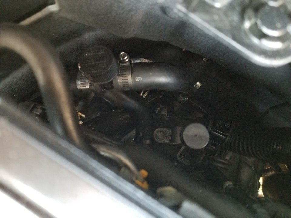

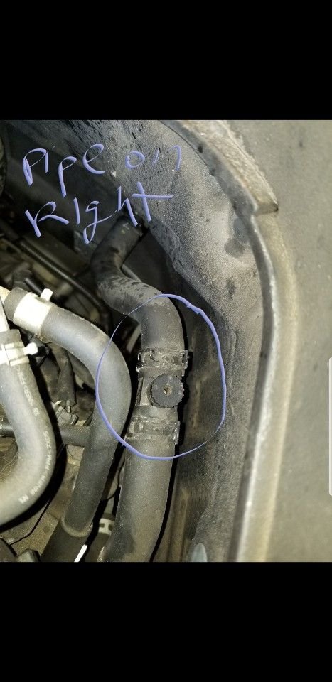

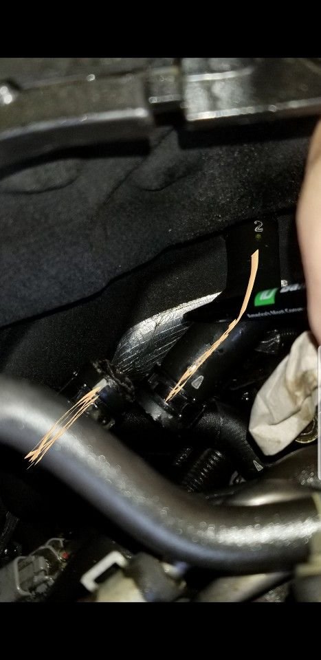

I took some more photos and it seems like its missing some kind of valve or cap. I took the photo of the same looking hose on the right side of the engine and that one has a cap on it.
I'm assuming the broken one had one too and maybe it completely ripped off.

Your bleeder valve broke - the plastic valve exposed to the repeated heat cycles of the coolant has either degraded over time or your thermostat is stuck closed. Both easy cheap fixes, just do them both!
https://www.z1motorsports.com/exhaus...rt-p-7634.html
That's the valve. You need to use pliers to move those metal clips, pull out the old broken bits, and pop the new valve on making sure the opening is facing straight up. I would do both sides if I were you since the right side valve is going to break soon too.
For the thermostat, make sure all the coolant is out of the car (remove drain screw on bottom of radiator w/ bucket underneath), then find the large hose going from the bottom of the radiator to the engine. That's the lower radiator hose. Take off the end of the hose attached to the engine.The assembly the hose attaches to is the thermostat. Unbolt that, put the new one on, and put the hoses and clips back on as you found them.
Then you gotta bleed the cooling system with the lilse funnel and 50/50 DI water/coolant mix, make sure the heat blows hot at idle, and then you're done. Top off the radiator every couple of days for awhile just to make sure everything went well.

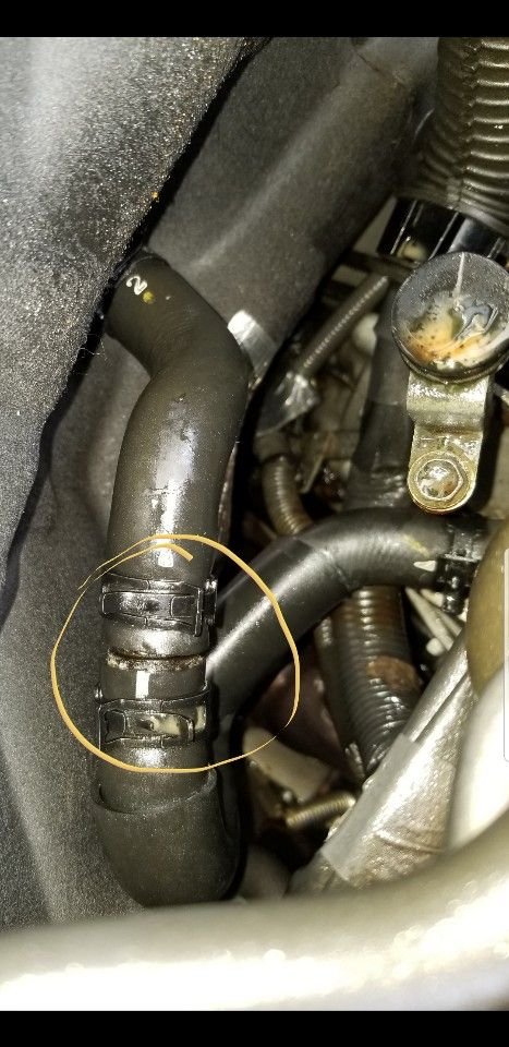

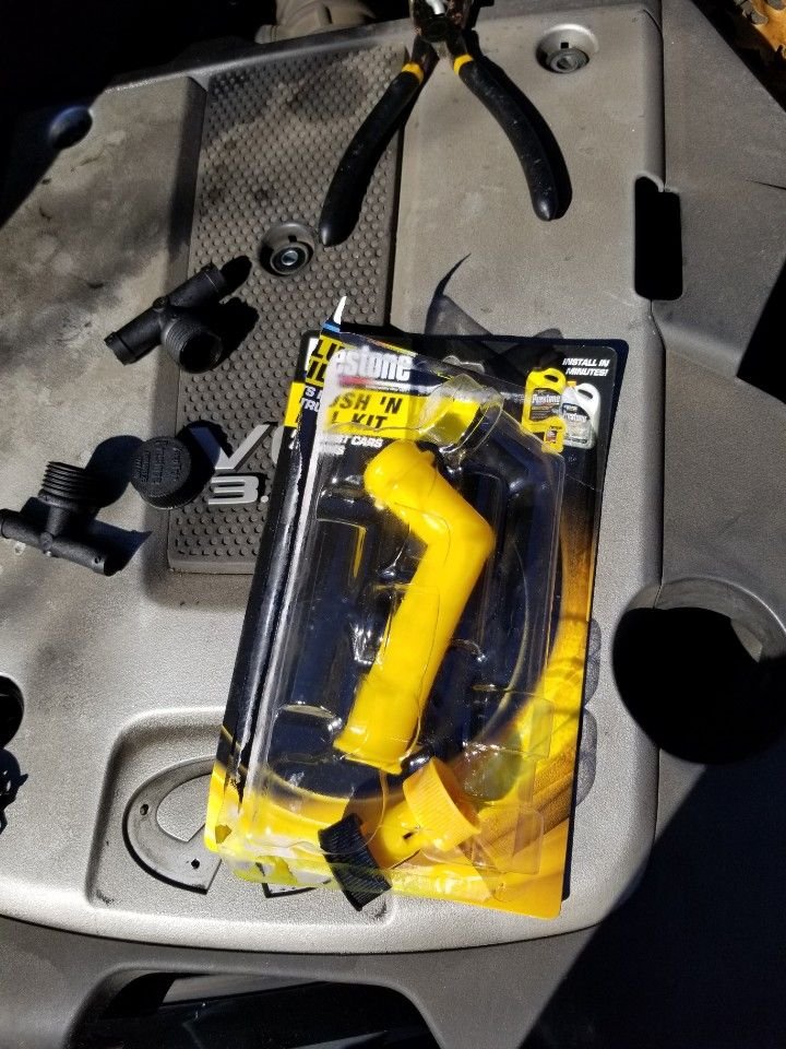

I saw a flush kit that had a part that looked exactly like it so I bought and connected it.
However, something is leaking from the car so I brought it to a mechanic. It was either the coolant or the transmission fluid. It was brownish color.
Least I was able to drive it to the shop after fixing the broken hose so I saved myself the tow money.

Awesome, good job! However I can guarantee the fitting you used wasn't designed to be used in a cooling system with repeated extreme temperature cycles and was probably designed as inexpensively as possible given its intended application. Might want to buy an actual coolant bleed valve and keep it in the glovebox just in case.

^ Didn't think about that. I guess I will purchase the right part and exchange it.
Do you know if anything (I'm assuming thats where the coolant flows through) will leak out if I take it out to exchange it?

You assume correctly, that hose sends hot coolant to your heater core where it gets used in the car's HVAC system to keep you warm, and the matching hose on the other side is exiting the heater core going back into the cooling system. If you take it off it'll leak coolant and then you'll have to bleed (not flush) the system again to get the air you introduced out.
