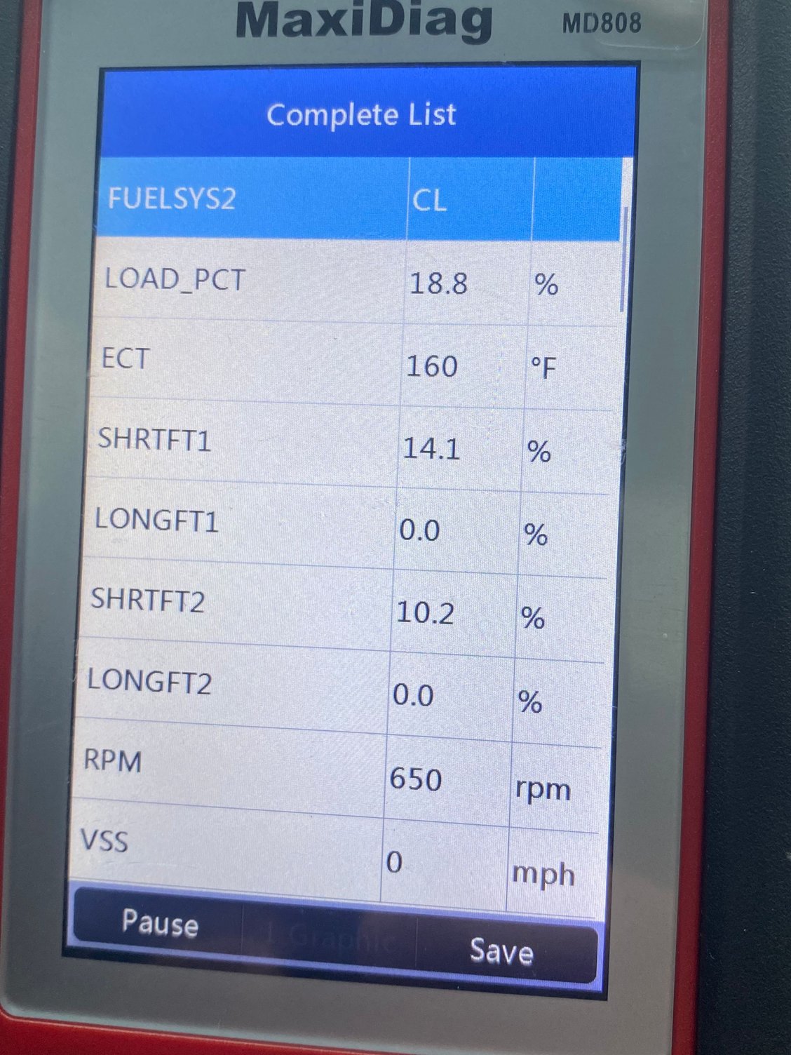

what's up guys I have a 2004 g35 coupe 6mt my short term fuel trims are pinned at 99.2% on both banks so far I've fixed every vacuum leak I have replaced both my upstream and downstream o2 seniors with denso. I have reset/cleared the fuel ratios and I have also replaced the Injectors along with spark plugs. the only code that comes on is p1283 air fuel ratio sensor 1 lean shift monitoring bank 2 this is after I did everything mentioned up above also new cats and new exhaust with zero leaks car has about 135k on it it does burn a f*uck load of oil.i just did the fuel injectors today and drove about 50 miles so far no check engine light but the fuel trims are still at 99.2% on both banks. also sometimes on first startup I would get a misfire that would eventually clear up.

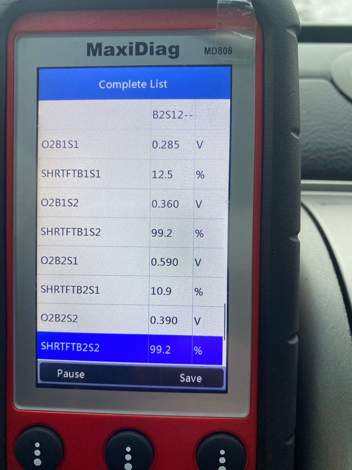

What data are you seeing on the sensor 1 O2 sensors?

for both upstream o2's im seeing 99.2%

Does it change at all when you stomp the throttle WOT and quickly release? It should lean shift quite a bit of watching real-time data. If it doesn't budge I suspect the O2 sensors are messed up.

Ok I see what's going on, those are NORMAL values. There is no sensor 2 short term fuel trim so the scanner is just trying to fill the box with SOMETHING, you can ignore those values. Everything looks normal though, you're still throwing that code?
I would pull and inspect the spark plugs, that will tell you EXACTLY what the conditions in the combustion chamber is like, post pics. If you're getting a lot of oil in the combustion chamber it's going to foul out the plugs faster and you might have to shorten up your maintenance interval to compensate. Did you use NGK PLFR11-5 plugs?

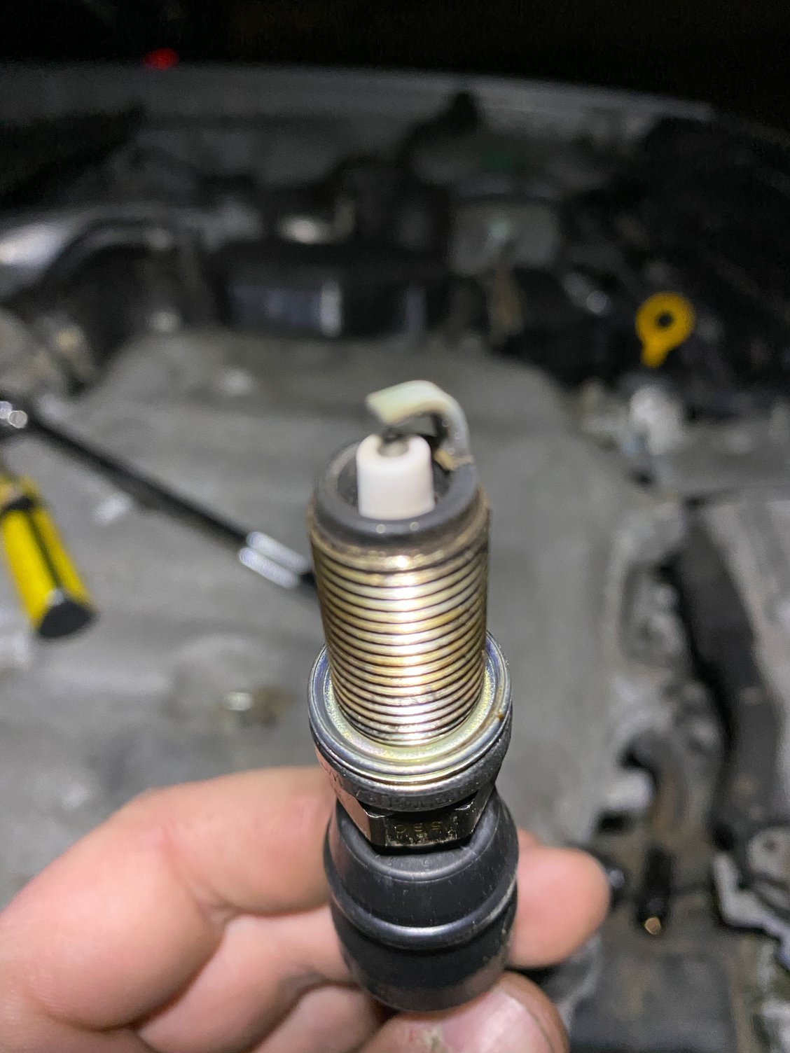

That makes me feel alot better lol but i cant remember what spark plugs i used i may still have the recite in my toolbox at the shop i pulled cylinder 1s plug the other night didnt look fouled out

Hard to tell from the photo but the center electrode looks like it's worn out of spec by normal usage. You should use a gapper or feeler gauge to make sure it's still gapped close to 0.043 inch. I'm guessing you use some kind of fuel additive? The deposits don't look too bad but definitely looks like some kind of additive is being used.

Yea i use techron with the oil changes im gonna order a set of ngk’s but you sure the fuel trims look normal?

Yeah the STFT looks fine, it's not giving a valid reading for LTFT so you might look around a bit more and see if you can find it. The CEL doesn't turn on until LTFT hits +/-25%. STFT fluctuates significantly and you're on/off the throttle under various loads so you basically use it for a reference when troubleshooting other issues.
My LTFT usually sits at about +12-14% it's how much of a baseline fuel multiplier is needed to compensate for things like vacuum leaks, injector clogging, etc. When you do an ECU reeset it puts the LTFT back to zero and the computer makes adjustment as needed.
STFT is a fast-acting trim for when you're climbing a hill as opposed to rolling on a flat highway, mashing the throttle and needing a little more gas than the baseline programming, it's more of a "1 second or less reaction time" to A/F trim.
If you mash the throttle then quickly let off your STFT will fly all over the map.
