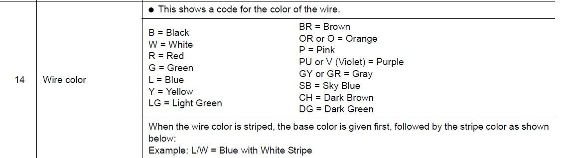

Just check the wire color on the harness, each harness has three wires. White/blue stripe is 12v power, black is ground, and a third wire that goes to the ECM
The third wire will be a different color on each coil.
Cyl1 - yellow/red stripe
Cyl3 - blue/red stripe
Cyl5 - purple/white stripe
Cyl2 - green/red stripe
Cyl4 - grey
Cyl6 - grey/red stripe
