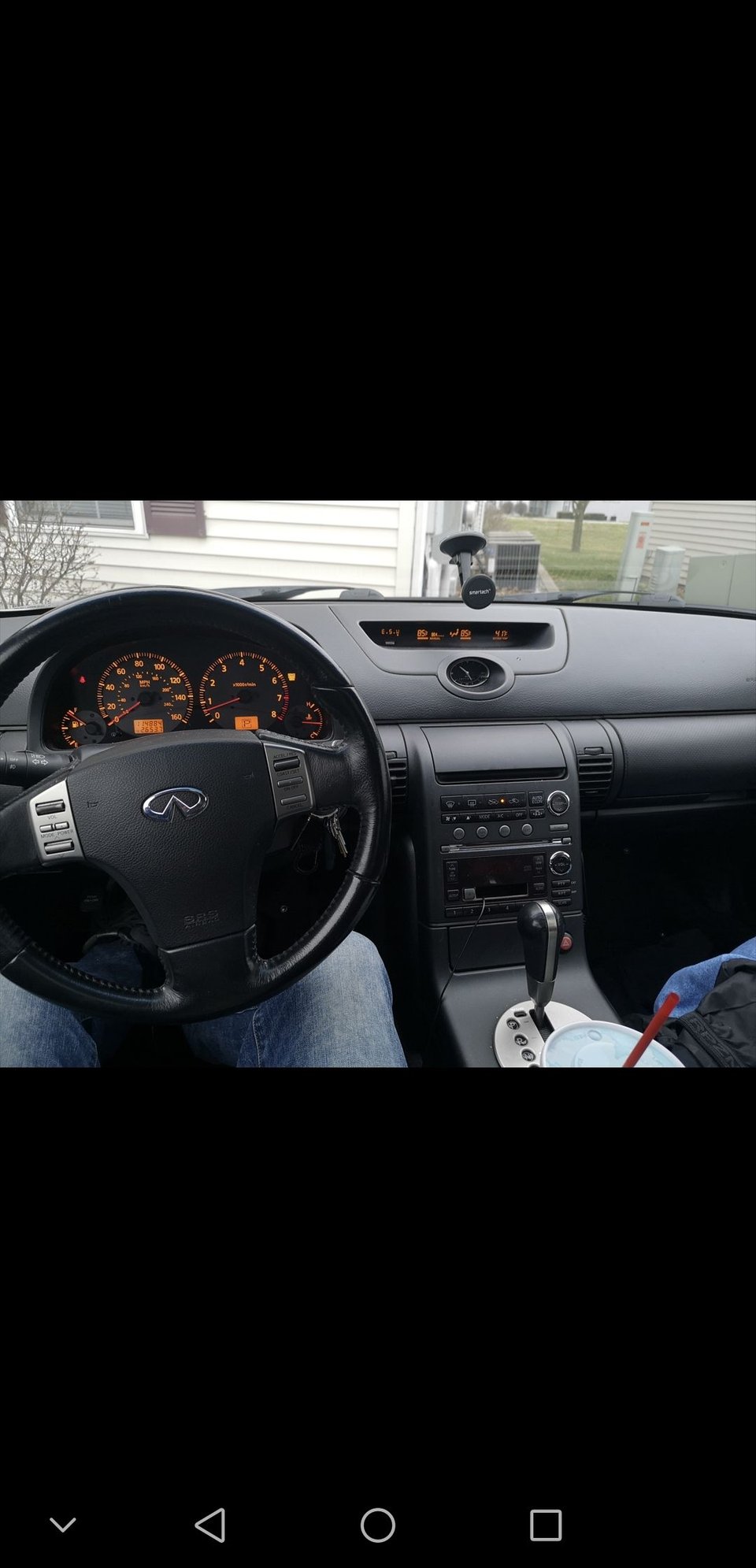

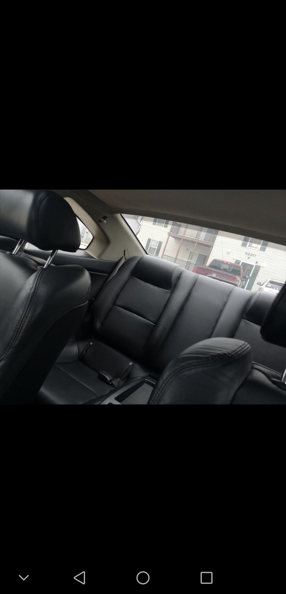

Hey looking for some advise Ive got a 04 paid off for 4 years now needs a decent amount of work. I need to know if I should keep it or junk it aka sell to car max. They offered me only 3k. With 120k miles its runs really great but the Illinois winters really jacked the metal under check the pictures.
I need to know about how much it would cost to keep this thing. A lot of ***** rusted out pretty bad. (cheapp! parts on ebay) But for only a few thousand I would probably keep it. I'm in Florida now and love this ride. I would wanna keep it, only if it makes sense for how much it would take.
What's your suggestions? Price? Ty!
2004 G35 Coupe
120k miles
Runs great, very responsive acceleration.
For sure has a oil consumption issues way worse if I slam but I usually cruse now days. Mostly =D
