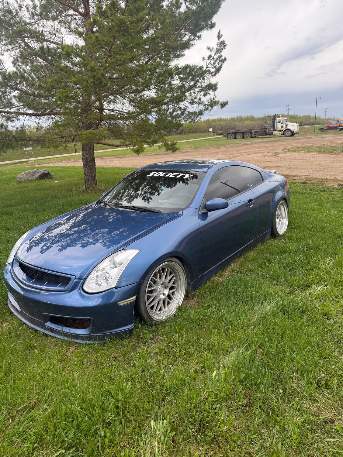

That G35 Ricer's Avatar
Joined: Jun 2026
Posts: 2
From: Canada
4.5” BC Xtreme low coils. Front body kit, CAI, Headers, short throw shifter, plenum spacer etc…
Tuning
Originally Posted by seymore4
The tuner version is only necessary if you want to be able to access and adjust the tune yourself. If you just want it tuned correctly by a professional, then the standard version (tuned by me) is perfect. I left you a visitor message, shoot me an email I'll get you set up.
Hey man, I’m new to this forum so I’m not sure if this is how to reply lol. If possible I would like a price for both options. I’m a heavy duty mechanic and have done tuning on diesels but never a gasser. Also I live in Canada so I’m hoping you can do the tuning remotely. Any help is appreciated, thank you.
