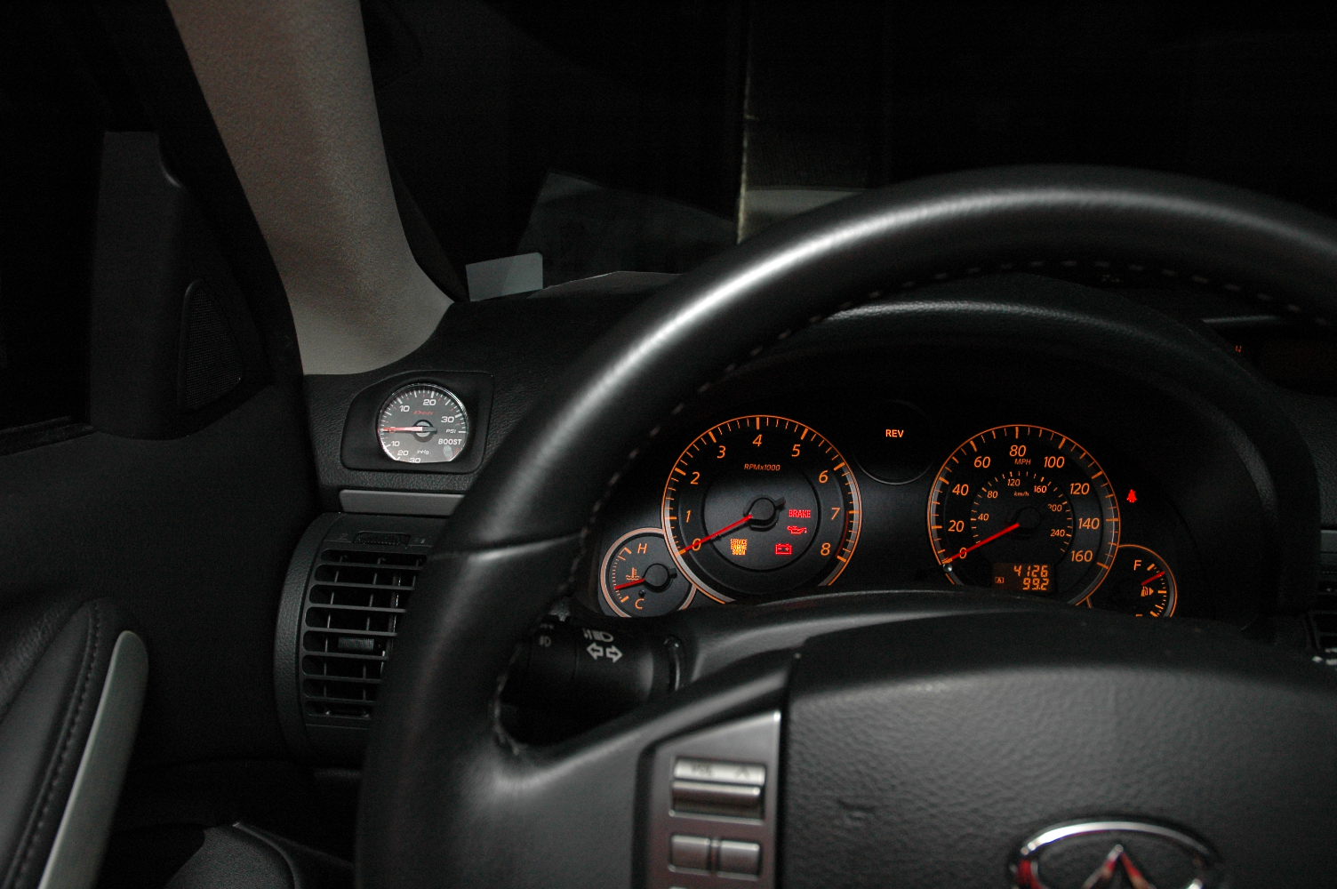

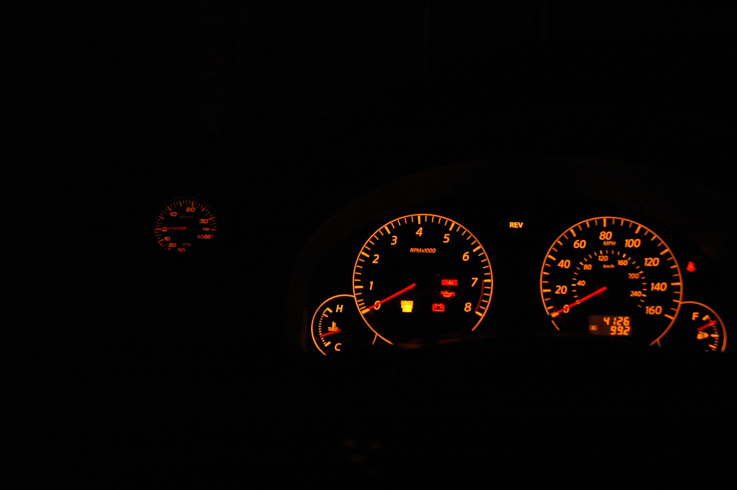

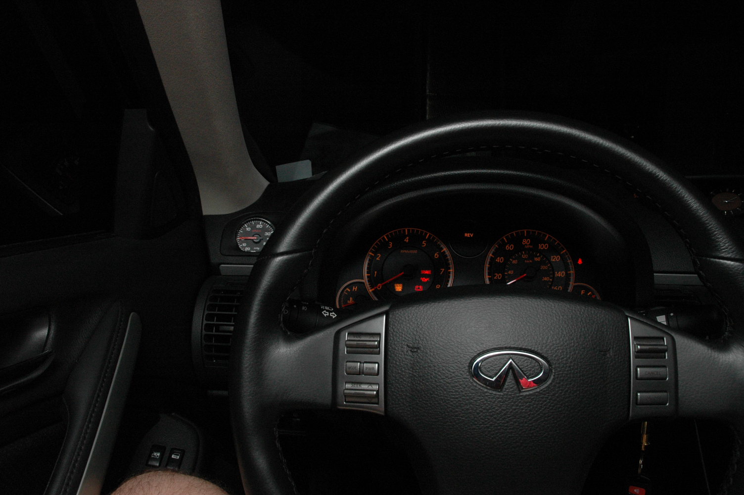

Custom gauge pod in driver's defrost vent. *PICS*
Gauge: Defi D-gauge
Material: stock vent, fiberglass, body filler, primer, flat black paint.
I angled the gauge down and toward the driver.
Hope you like the pics.

here's another pic....better angle, sorry about the camera shake. I had to use a very slow exposure.

Sadly, nothing yet. I only wanted a manifold vacuum gauge, but Defi doesn't make one in the D-Gauge series.
I went with the D-gauge because of the amber backlighting and the clip-on trim ring.
The trim ring is how I mounted the gauge. If you notice, the gauge is mounted from the back of the pod. I molded the trim ring into the vent. That way, the gauge slides in from behind to give it a clean,professional look.
