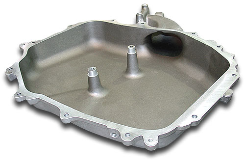

Everybody knows what I like. Funny how some others are starting to look very similar.....no? What's that cliché' about a form of flattery?..............
Attached Thumbnails plenum, plenum spacer, mrev ...-dscf0002.jpg   plenum, plenum spacer, mrev ...-dscf0008-2-.jpg   plenum, plenum spacer, mrev ...-plenum_inside2-1-.jpg

The MREV comes with a 5/16" plenum spacer, as does the ISO Thermal gasket and the CCV (Coolant Control Valve) . The only option in the MREV package is whether you want the "Plus" option or not, which is a modified lower collector/lower plenum or the regular one. I opted for the modified lower collector . . . I figured what the heck.
