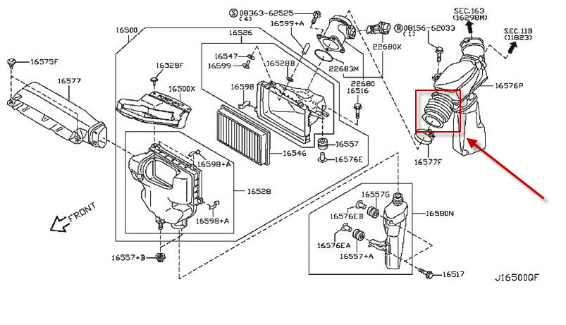

Hi all,
I need to acquire the little rubber part of the OEM intake tube. Mine developed a crack and is currently being held in place by some ductape. Buying new isn't an option as the part is only sold as a whole and it's almost $200 with tax.
If anyone is selling please let me know.
My car specs:
2005 G35 sedan
Attached Thumbnails WTB: 2005 OEM Intake Tube-g35-intake.jpg

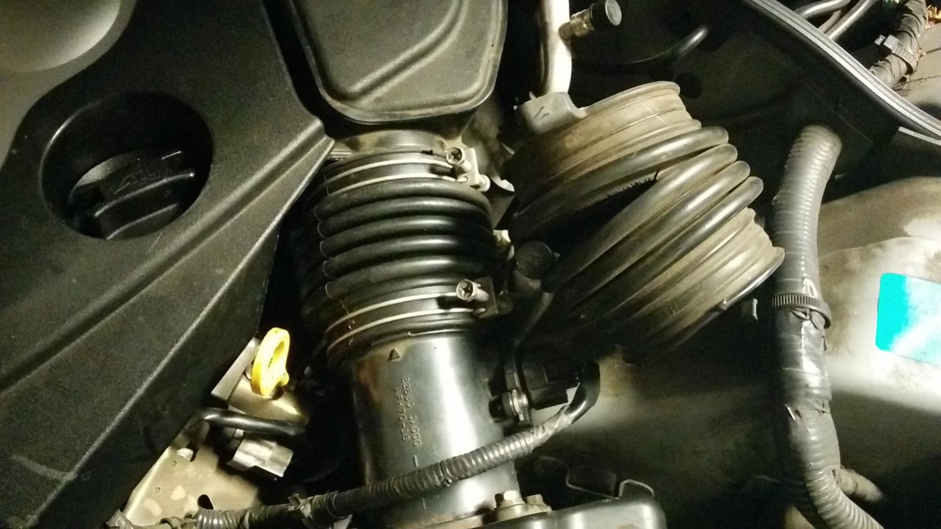

Well I purchased the part from the dealership, comes from a 2002 Maxima. It fit well. The item has one extra coil-lookin-ripple thing so it's slightly longer than the Infiniti part, but it fit perfectly. Again, thanks a ton for the tip. I appreciate it.
