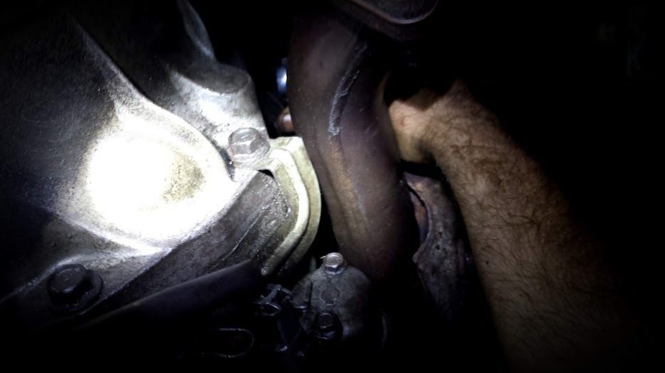

I spoke too soon, although i can get a swivel head ratcheting wrench on the driver side top mount bolt there's no room to turn the thing without having it come off the head, and no leverage anyways...

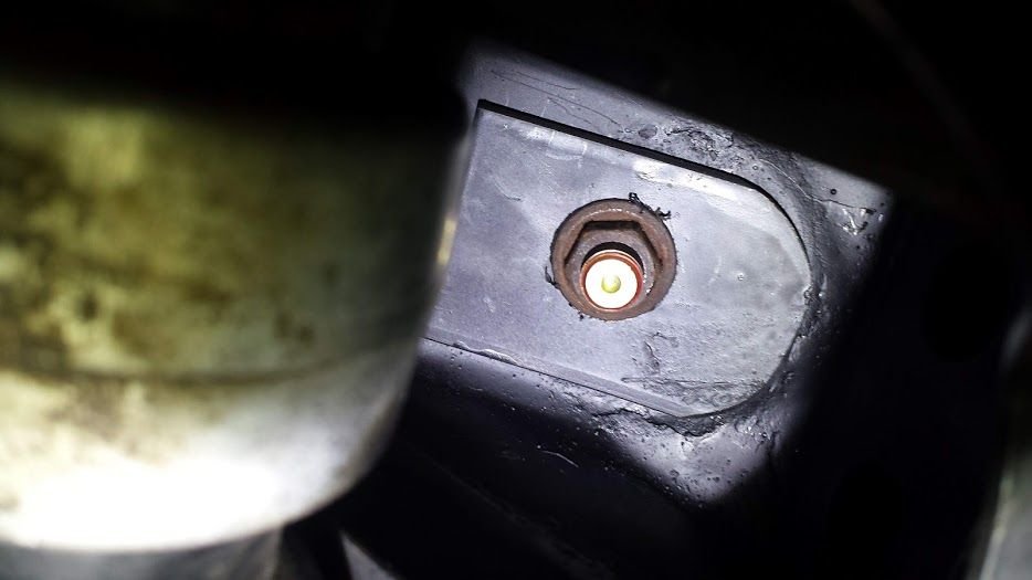

There is is all the way at the bottom! Note the terribly designed wings on the motor bracket preventing access from any direction but directly facing the frame... Doh.
This is as far as I've gotten but because of that angle and an inability to get leverage the tool always slips off.
