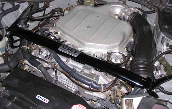

Originally Posted by Brando
Sorry Guys,
I'm stating my opinion only. After some more driving and hard cornering...
IMO this is a cosmetic upgrade only. I feel no real benefit other than looks. If you are good with that, great.
The alum bar is tooo soft and allows for way too much flex to have any effect. IMO
Think about it....under hard cornering, how much flex/deflection do you think there actually is between the tops of the strut towers??
1/8" - 1/4" maybe? This alum bar will allow that much flex with no problem, negating any effectiveness. The bends in the bar defeat the inside bracing. The mounts are great. The bar needs to me made of a much stiffer material.
JMHO
Terry B
Hmm, I was afraid someone would report something like this. I guess in the end it comes down to, you get what you pay for. I was an early advocate for the VRT bar because it just plain works. This may sound silly, but as I've said before, I could immediately feel the difference in stiffness. After the install, when backing out of my garage over the crown on the driveway, my coupe felt stiffer. The VRT truly transformed the handling caracteristics of my coupe. I've put on about 5K miles with this STB, and I would not go back to stock. It's a great upgrade.
Lou

Cool
Don't let me scare you off if you really want one......I'm still testing.
It actually helps stiffness some by just bolting the SS mounting plates down on top of the towers.
It just was not a WOW big difference for me. I still say the bar is too soft and alum is not the best material.
Here is a link to a good article on strut bar design principles:
http://www.rogueengineering.com/Merc...&Category_Code

From: Ontario Canada
The BIW of the G35 is fairly stiff to begin with so I would doubt that you would notice a big difference regardless of wheter you have a strut bar or not. Essentially, any 'linear' bar for the G35 is cosmetic. If you take a look at the Modulus of Elasitcity of TI (ARC) vs Aluminum (Richie), you are looking at less than half of the stifness. However, the moment of inertia for either bar given the packaging space is relatively small so you will not likely notice a difference regardless of the material. ALSO - this bar is not triangulated. Perhaps you would notice more of an impact if this was the configuration.
Regardless, if the chassis flexes 1/8", I doubt that a $700 titanium strut bar with give you the WOW factor that you are looking for.
I think a better comparison is to take both the ARC strut bar and the Al Richie bar on a road corse and see if your time/performance improves. To say that you notice that backing out of your driveway or taking an off ramp you notice a huge difference is speculative at best. I would rather see some comparative data to back it up.

Cool
Ok.....after further testing and hard flogging.....
I do feel a difference.....no way near a $700 ARC price kinda difference...
but prob worth the $225.00. Steering is a little tighter.
Just bolting the stainless steel brackets on top of the strut towers prob helps a good bit. I still think the bar could be a lot stiffer.
JMO
