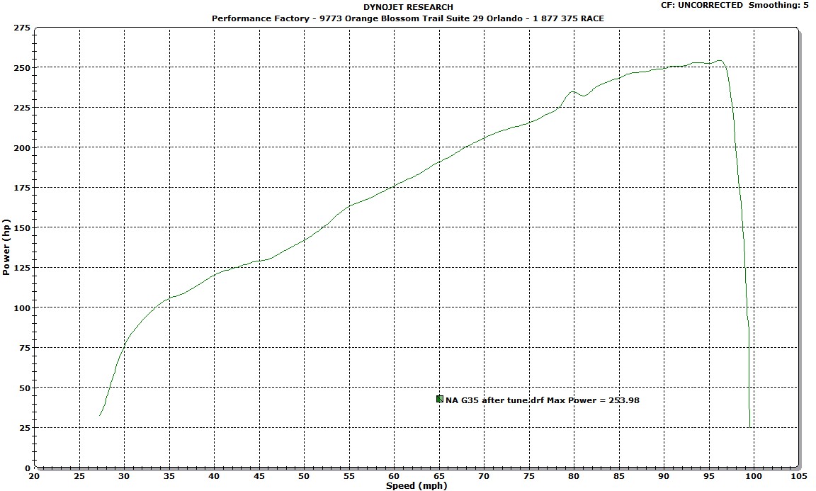

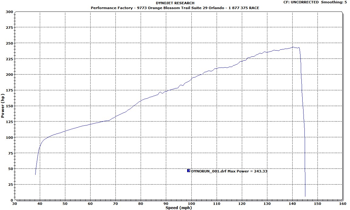

Here is my before and after.
Attached Thumbnails Utec and Tune-g35-na_g35_baseline.jpg   Utec and Tune-g35-na_g35_after.jpg
