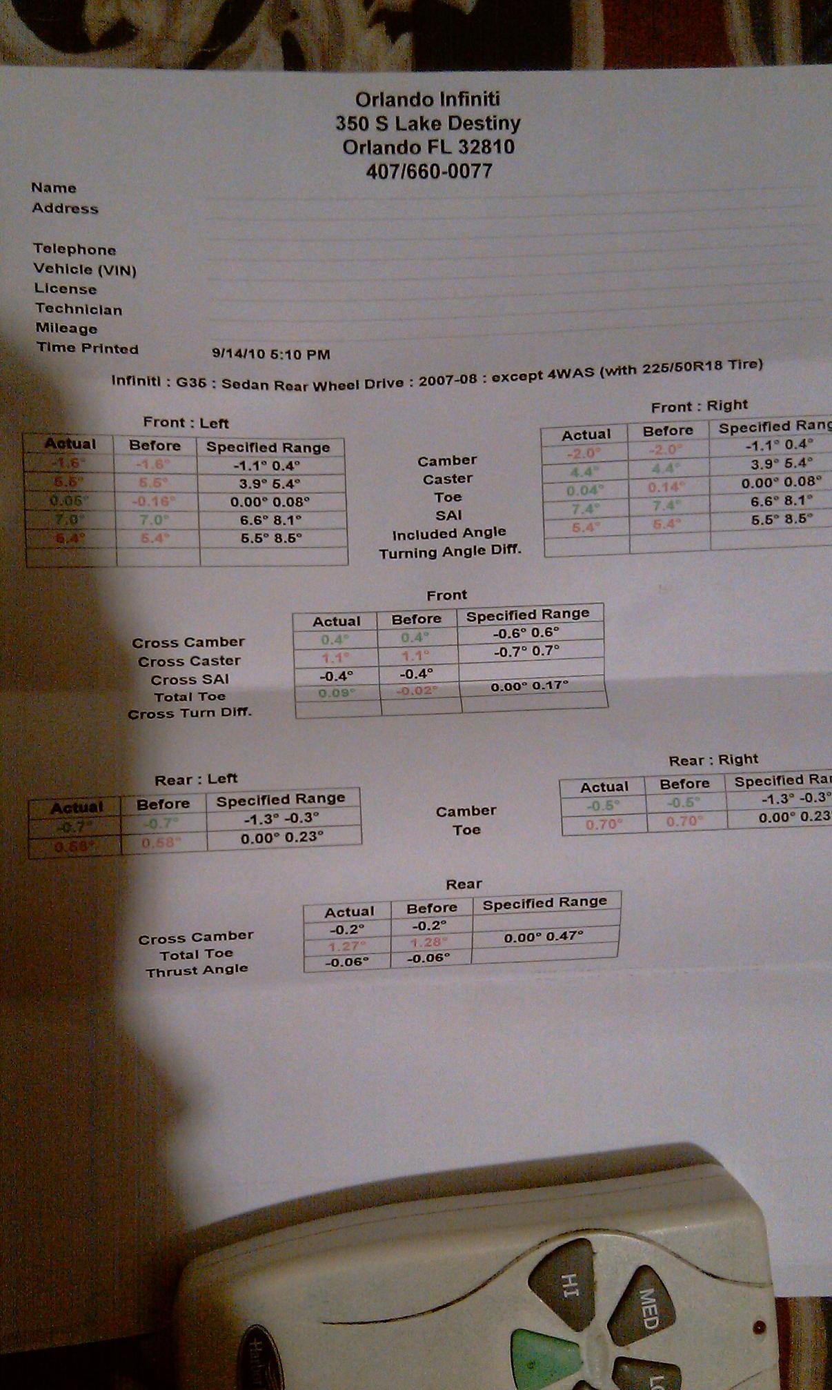

check the alignment sheet... my toe is horrible i ran through a set of tires in 3k .... also will your front camber arms fit on my car?
im going to go back and ask them to redo it i just dont have time tho

Did you have the camber arms and toe bolts installed in the rear? With that much toe, i would think they would've told you about this.

So you don't have any camber kits on your car?
If that's the case, then the only thing Infiniti could fix, they did fix. Which is your front toe.
And yes, if you have a g35, then my camber kits will fit.

Fixing rear toe is a simple thing to do. Since it's so simple, it wouldn't make sense to me that they couldn't unless there was too much adjustment needed than what the stock toe bolt could offer. The stock toe bolt has a minimal amount of adjustment. That's why aftermarket rear camber kits have a replacement toe bolt.
I guess it is possible that Infiniti was too inept to turn a simple bolt, but I find it unlikely.

Looking at it again, it seems like the rear toe wasn't changed at all. Maybe they felt the toe bolt was already maxed out and they didn't even try.

i do have the spc rear camber kit installed... tho i did not install the toe bolts... I have the 07 g35 sedan
Sen will you camber kit fit on that?
also i think im just going to take it back to infiniti cause something tells me they def didnt even look at it

But if you didn't install the toe bolts, you may have difficulty finding anyone who will be able to fix your rear toe.
I'm not sure since the 07 g35 sedan is a v36. I should have been more clear. The camber kits should be good for v35 or z33.

well, if you dont have the toe bolts that is probably the reason why the toe is off. Im pretty sure someone did the alignment on it since your camber in the rear is even at -0.5 on each side. But they should have told you they couldnt get the toe in spec. out of spec toe will easily wear tires faster than a little camber.
What springs are you dropped on? Im getting ready to put some Tanabe NFs on my v36 sedan and was wondering if I could get away w/o a camber kit or toe bolts.
