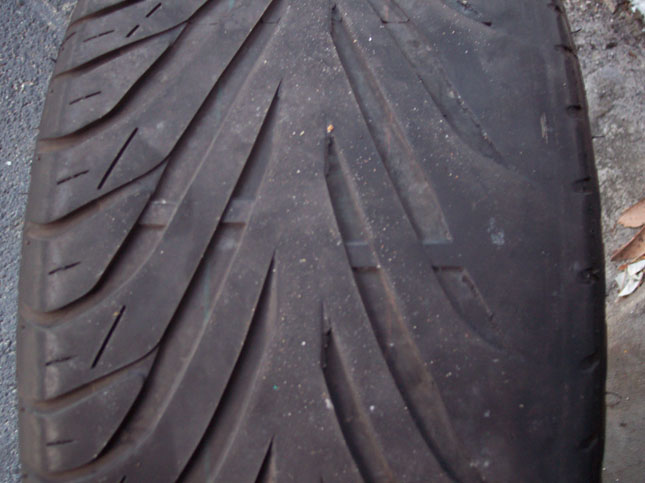

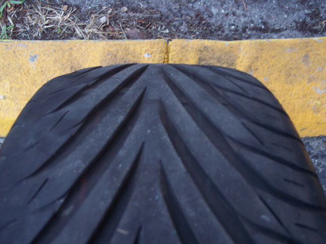

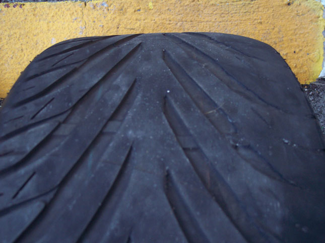

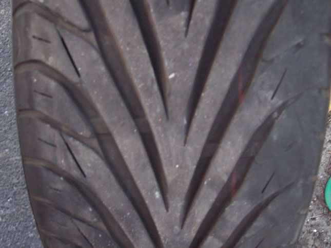

Does anyone know of a shop in Orlando that aligns lowered cars? Goodyear and Allied Tire will not because it is too low. They mentioned a place out Nixon Black? off of OBT or a Goodyear out in Celebration...please tell me there are places closer than that!
The tires are on. Compared to the weared T1-S tires, these tires are "Lexus" style....they are so much quieter, it's ridiculous.
The first 2 pictures are the 245s. The last 2 pictures are of the 275s.

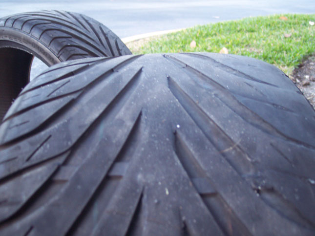

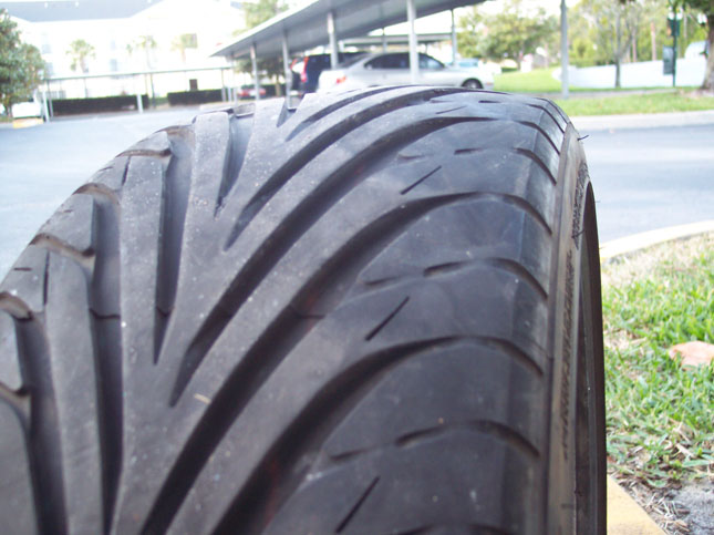

Last 2 comparing the camber

Ryan, there is plenty of tread left on one side of each tire. you should have just mounted them on the other side of the car for even wear.

yeh that would have worked if he was always driving straight.
but if he tried to take a turn at any type of speed he would have found himself sliding.

Those look just as bad as mine. What's weird is... my tires wore out on the outside, not the inside. Does that make any sense? I thought it would have worn the insides more since I lowered the car.

Well, I had my car aligned at Tires Way of America today. They said it would be $80...after taxes, it was $93.xx. It was nice to pull up, fill out paper work, and then have them get right to work on my car. It only took about 45 minutes, but they didn't do much. They said they got the toe in back to spec. I have no clue what spec it should be, so I'll just post numbers. O yeah, and they said the front/rear camber cannot be touched. It's funny how Wes had Lokey adjust his front camber back to specs...even though he has the SAME springs I have!
Before:
LF: RF: LR: RR:
Camber- -1.7 -1.8 -2.7 -2.5
Caster- 8.0 8.2
Toe- -.17 -.17 .02 .09
After:
LF: RF: LR: RR:
Camber- -1.7 -1.9 -2.8 -2.6
Caster- 8.0 8.2
Toe- .04 .04 .10 .11

If they didn't touch your camber, how come it changed .1 (worse)
And if the rear toe changes from .02/.09 to .10/.11, doesn't that mean it's more off?
