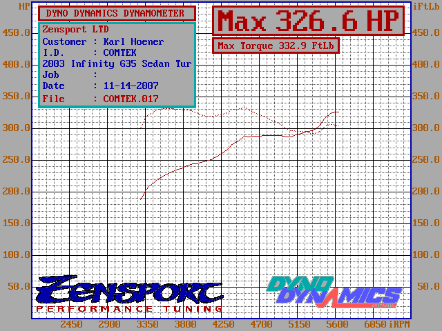

Here is one of my first dynos from before I changed my fuel pump...

You cant really do any street tuning without a good logging software. find out first were you are knocking and start from there. why is your TQ dipping like that? Is the ECU Pulling some timing? You want your timing the lowest on TQ Peak and gradually add timing as your TQ goes down. pull some timing around 3400-4500rpm and see if that happen.

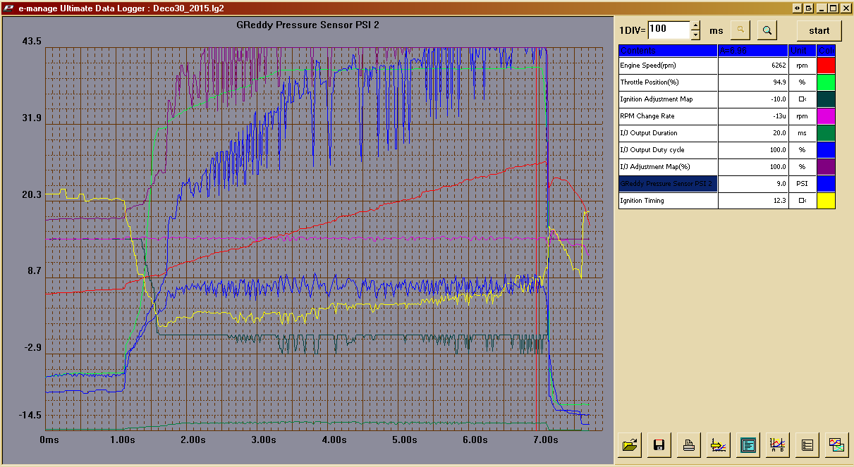

OK, I went out and made a few logs. In this one, the item highlighted in the legend is Boost. The red vertical line is the point in time relating to the details in the legend. Unfortunately, you need the Greddy software to allow you to see the scale of each of the items logged, but in this picture, you should be able to get a good idea of what is going on by relating the curve of each item and looking at the legend to see the value at the red vertical line. I selected boost in the legend, so that is the scale displayed to the left.
The red horizontal line is the engine RPM (at 6262 rpm at the vertical red line). The starting RPM on the left was 3200 RPM. Ignition timing is the yellow line - starting at 29.5 degrees and dropping to a minimum of 1.7 at 1.63 seconds on the graph. Timing adjustment is the black line. The flat spots are -10 degrees from stock with the max adjustment at -12 degrees at 9 lbs boost. I had adjusted all cells to -10 deg of timing for boost of 1 to 7 lbs for that run to see if it would stop the knocking sound. I didn't really notice a change.

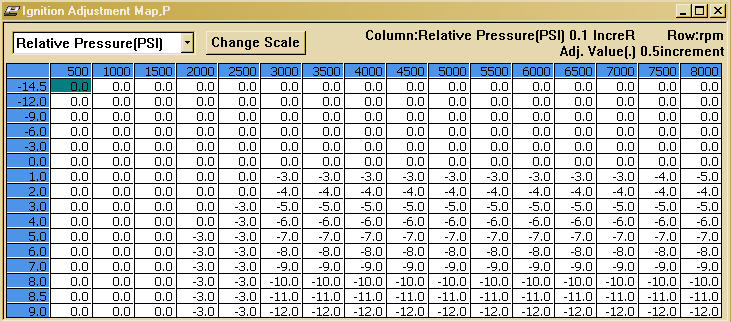

Here is my timing adjustment map:

So if I'm reading it correctly, your timing was between 1.7-8.7 and A/F are from 10.5-11.0 when on boost, then I don't understand why are you still knocking. Do you know which RPM you are knocking? By they way, to much timing retard will raise your EGT.
