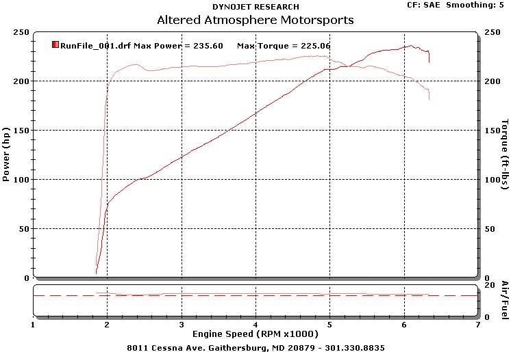

I just started a twin-turbo build up on my mostly stock '04 6mt. I'm the original owner it's got about 34k miles on it. It still drives like it's brand new, no complaints at all...however I'm starting to get tired of being slapped around by all the GTO's and G8's around here.
So far all that's been done is a baseline dyno run, however work is going to begin very soon.
My goal is 400WHP, and we're pretty confident about reaching it.
Comments/suggestions welcome!!

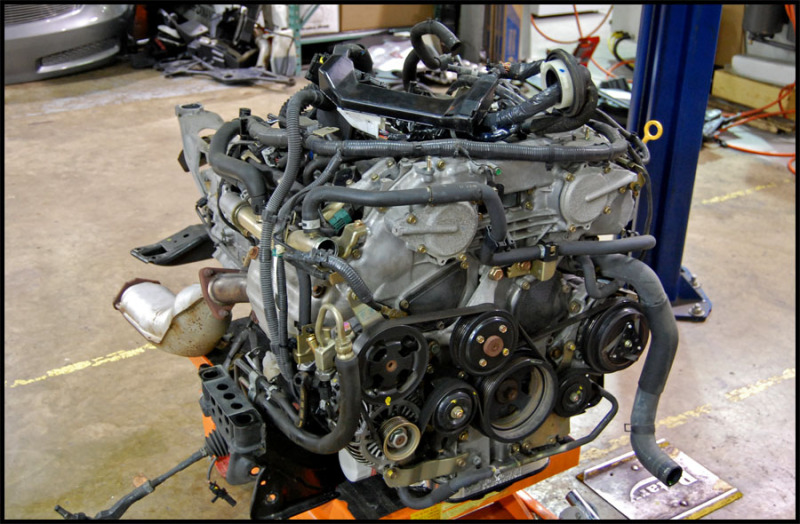

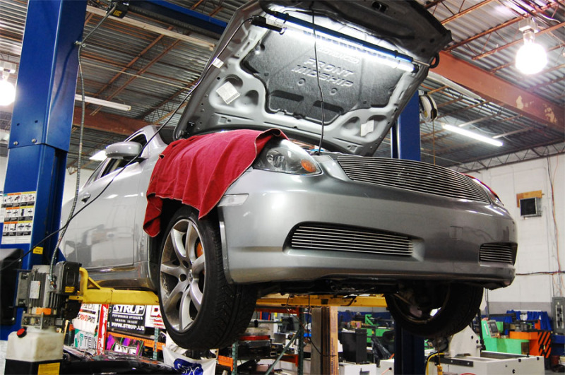

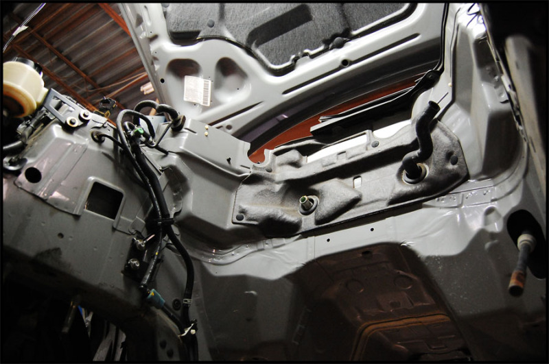

Work has begun...
More to come soon.
Attached Thumbnails new turbo build-rm_1.jpg   new turbo build-rm_2.jpg   new turbo build-rm_3.jpg   new turbo build-rm_4.jpg

Originally Posted by djamps
Thanks for the tip. The shop is taking video of the dyno runs and pics of the build as it progresses. I should have some pics of the engine removed today or tomorrow =).
I promise I'll make it more interesting hehe
You delivered with the pics! Nice. Can't wait to see and hear more.
