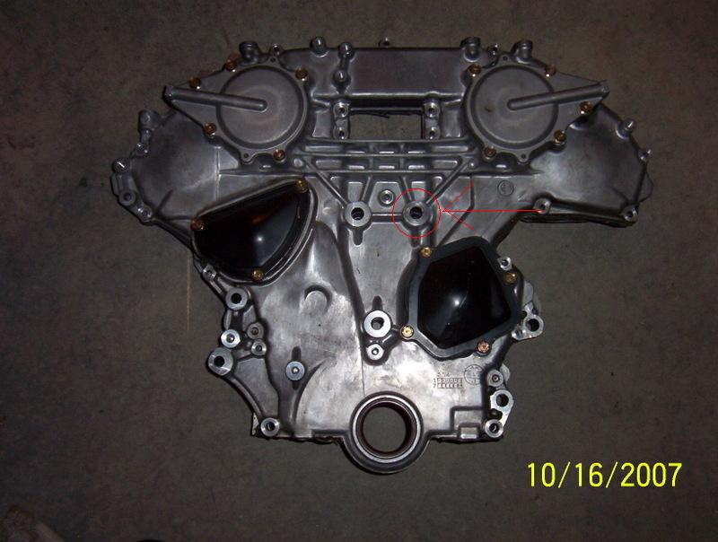

I can't seem to find the original bolt after uninstalling my Vortech. Anybody know the size/length? The one I took off from my Vortech mounting plate is too long for this spot.

Its a M12 1.75 pitch X 110mm I believe is the one in the kit, so subtract the thickness of the plate so maybe 85mm

IT's wierd though cuz the Vortech install guide says to reuse the bolt, but it's totally different. *shrug*
Need to swing by the auto parts machine shop and find one. I bet the dealership is going to charge $15 or something for it.

that's the bolt you use for the cog belt tensioner. you must have it, unless you sold your vortech already.

YES! that's it!!! Thanks so much...found it and it's back in place.
