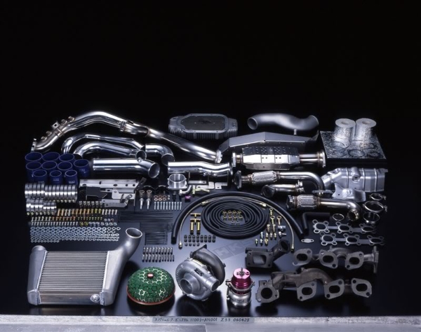

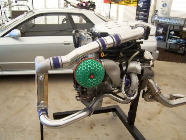

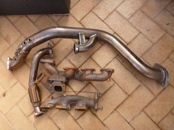

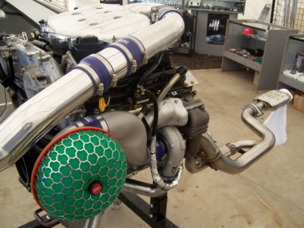

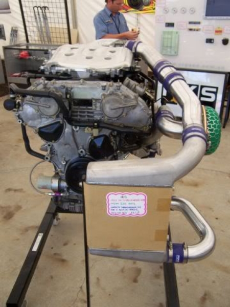

After plenty of thinking and dwelling on the advice from a discussion on another forum about the constraints of welding/modifying cast iron manifolds i have decided to take a different path for the build.
The manifolds will not be modified. The turbo position is going to remain in the lower position like the VQ25DET & VQ30DET. This is now achieveable with the use of a HKS 3037 like the HKS Single Turbo kit. Surprisingly enough, HKS simply used the VQ25det manifolds for their kits Nice!
I found out more info on the HKS Single Turbo setup in the past couple of days and i plan to base my kit around theirs.
From what i can see from the kit it seems that this would be the best path to go down with some slight changes.
HKS Single Turbo Kit - 350z/G35 (approx 270rwkw-300rwkw)
The last thing i want to do is have to do this twice so im going to be spending a little more more money on the turbo and waste gate setup.
I will be keeping an eye out for a HKS 3037 or similar for the turbo. Seeing as they work well with the numbers im chasing, it is a win win.
Recalculating the build costs it looks more like this. Take into account this is with QUALITY core parts.
VQ30det manifold - $50 (purchased)
HKS 3037 Turbo - $700
Turbosmart OR HKS 60mm wastegate - $500
Intercooler & Piping - $400
Hoses/Fittings - $100
Deatschwerks Injectors - $300
Deatschwerks fuel pump - $155
Oil pan spacer - $180
Oil feed lines/Return lines - $125
Catch can setup - $80
Sparkplugs - $80
AM Radiator - $200
Genuine HKS BOV - $80
Approx. total before tune = $2,950 NZD ($2,430.21 USD)
That is less than what i have seen the Turbonetics kits going for
Not quite pennies but very reasonable for a supposedly reliable and well put together kit.
There are a couple of the things which you could strip back if you were wanting to be on a very tight budget:
AM Radiator - $200
Total: $2,570.00 NZD ($2,116.90 USD)
Time to get collecting!!!
