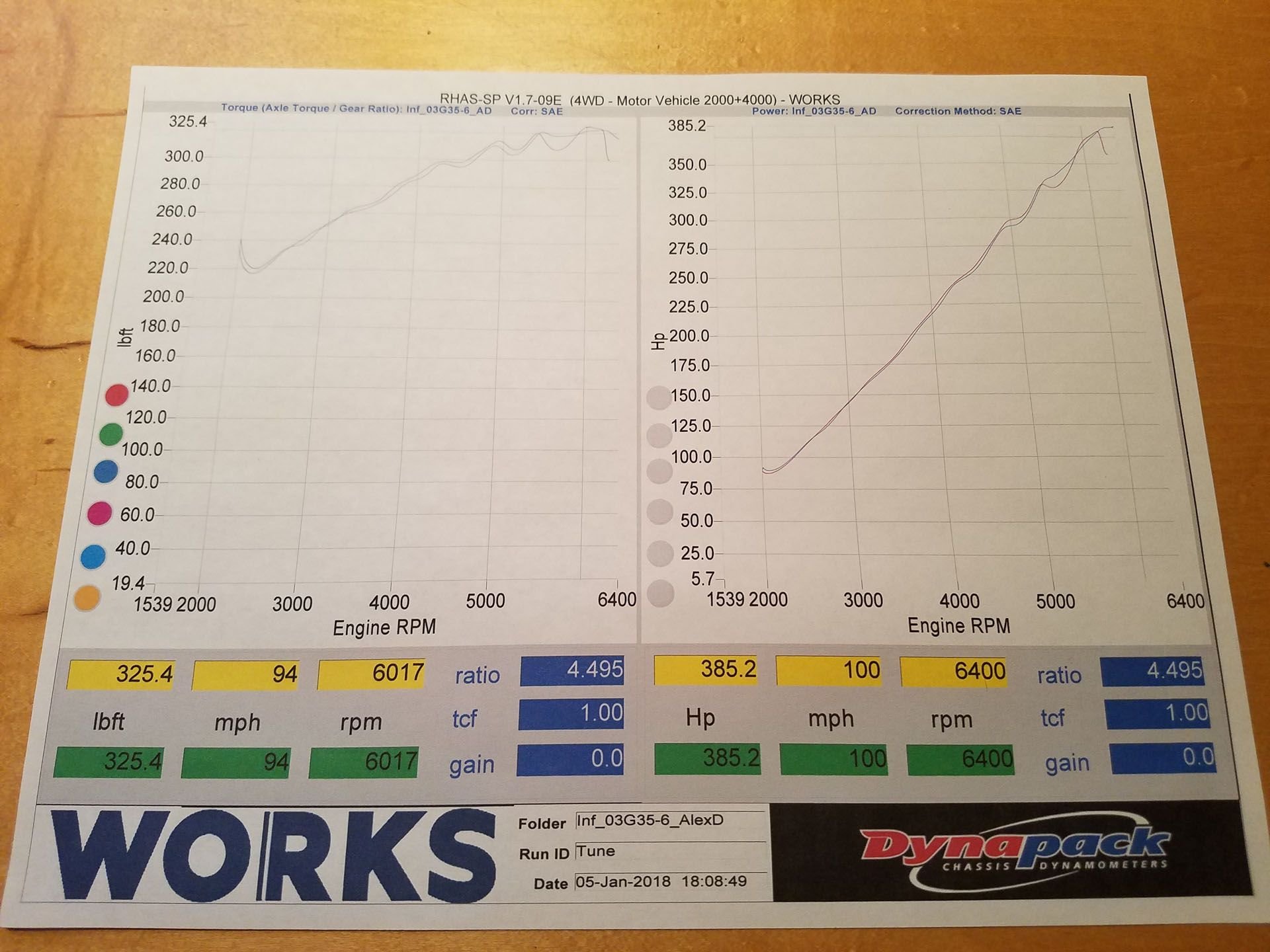

After a year of running the complete vortech kit, and zero issues, I picked up a 3.12 pulley to see what kind of trouble I could get into.
After some initial data logging it became obvious I was leaning out at higher RPM's... In fact, this was expected.
What was not expected was my tuner explaining to me that I was running out of fuel on the top end-- that my (stock) injectors were not able to keep up... I looked at him confused --explaining that every guru on the forums inisited the stockers were good up to 400hp...
His finger then floated over to the number below... "You're way over 400 at the minute"
Some quick math 385 x .175(cpe power train losses) = 452HP!
I reminded him this was a stock block with over 100k on it. We decided it would be best to lower the rev limit to 6k (where it was leaning out), and shoot for 9psi at 6k.
Overall, couldn't be happier with this setup.
