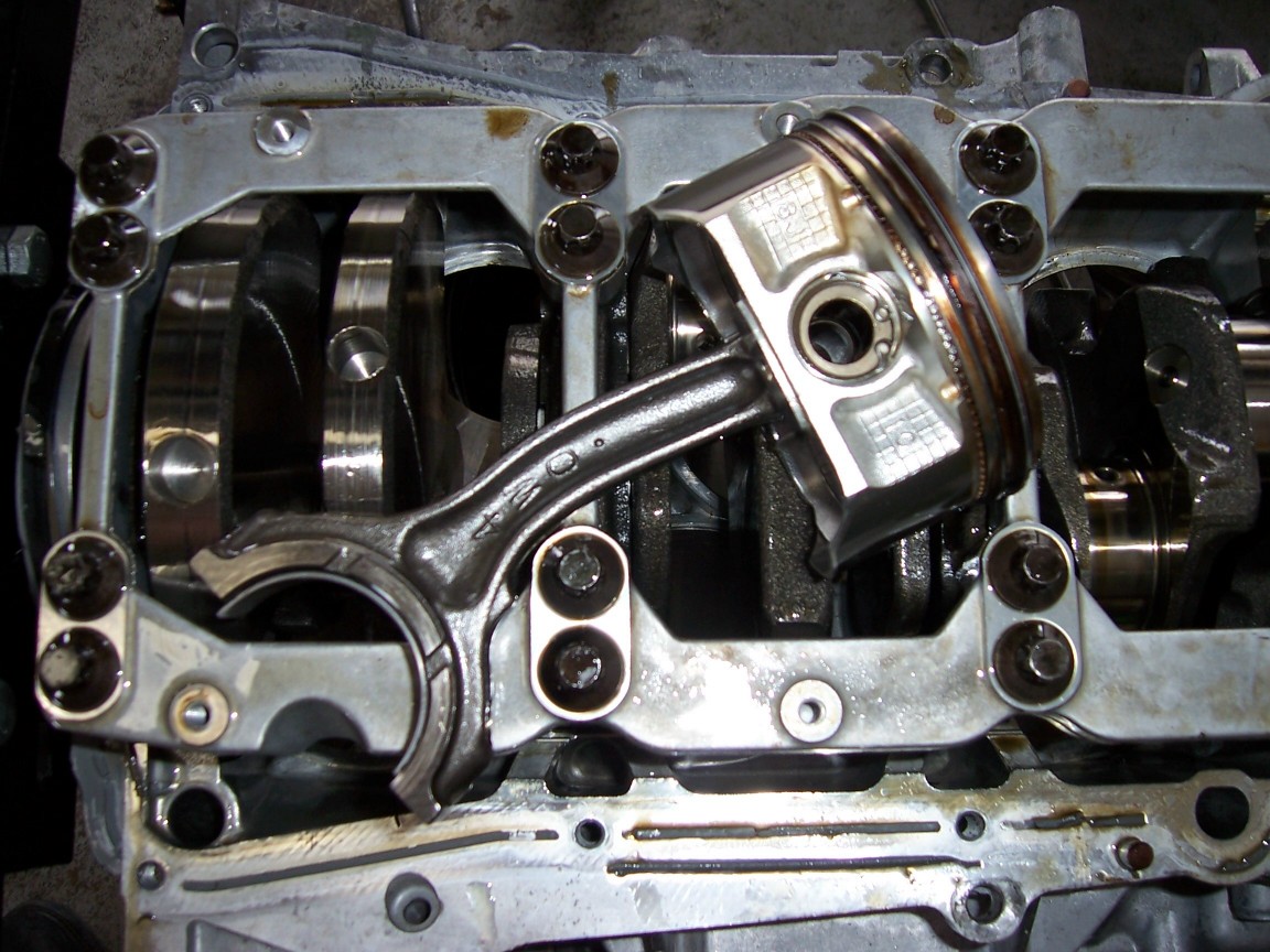

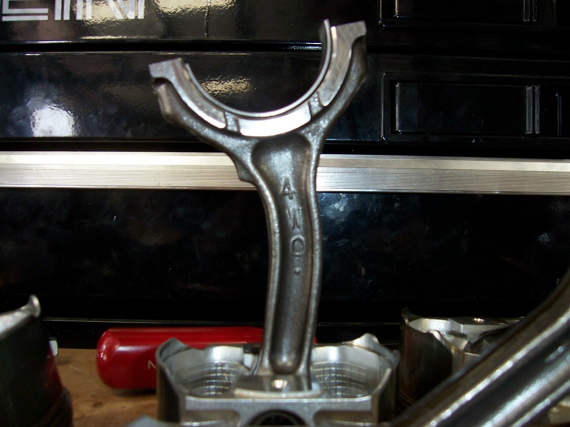

When I bent a rod the motor would not turn even when I tried to turn the motor with a crowbar.
Since you are in TX you should check out SGP. They have a lot of different motor packages starting from $2700. www.sgpracing.com
Good luck!

damn Gman, those pics just made me cringe bigtime.... was that your stock rod or the built bottom end?
EDIT: looks like the stock one to me?
yes that one is the stock rod.
