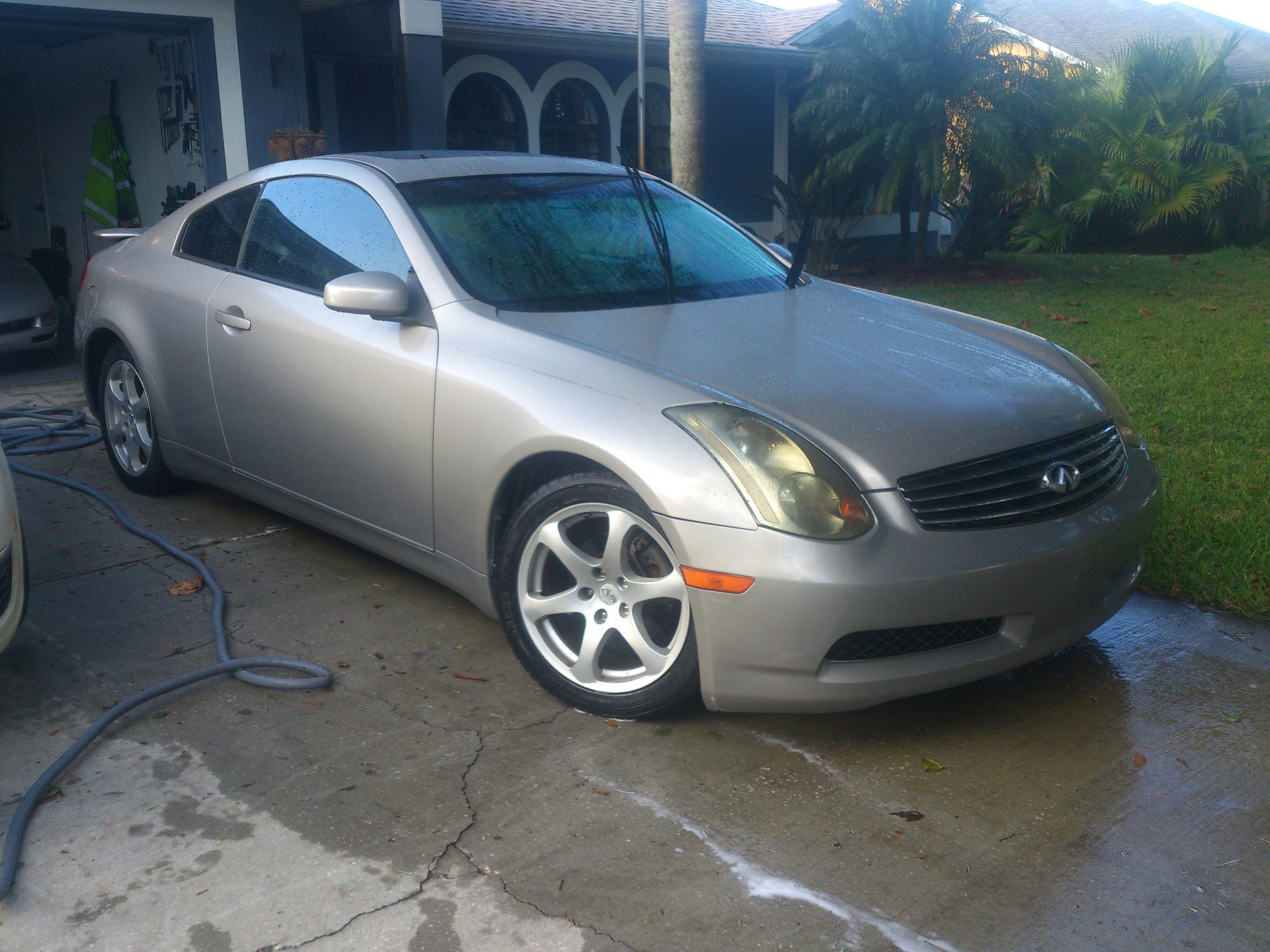

After a wash but before I buffed out the headlights
