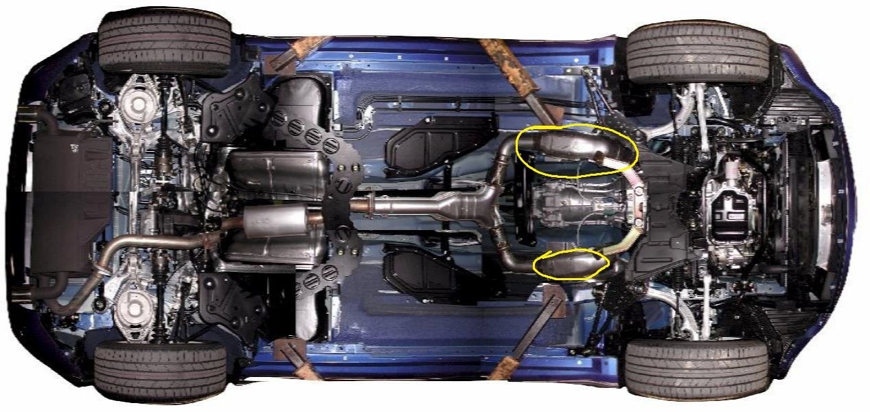

So the stock exhaust system is 2 headers- 2 cats-single y pipe-single mid pipe-single muffler. They are all separate components that bolt together with flanges and reusable gaskets.
Basically it STARTS as dual but converges into a single exhaust at the y-pipe. Here is a photo of the stock setup on a coupe. Circled in yellow in the catalytic converters.
