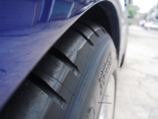

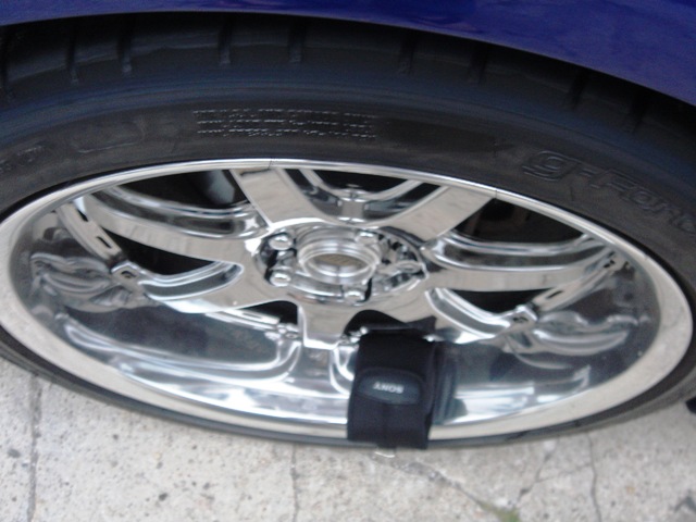

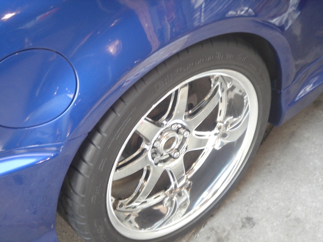

HI squads and g35 lovers my car is out of the shop! and had the rims on but BIG HUDE PROBLEM WITH RIMS!!!take a few close look its rubbing crazy on my fender!!!my car is STOCK.wat should i do!???thanks for the help guys!
pic r poor sorry... camera suks!

Your car looks great. Color looks really nice and parts seem like that match up well. Congrats...
Maybe you need to get your fenders rolled. I think member diesel1 does fender rolling ( he has the tool). PM him, he probably will be able to help you.

whats ur rear tire size?
1. roll & cut your fenders
2. negative camber
3. run 275/35 series tires
4. raise ride height

hey vin,sup man...my tires is out from the fender by few cms..i think its actually rubbing on the corner panel....do i need new suspensions? stock/spring too bouncey?
ps:my car is 03 stock suspension.

Talk to Drew aka Diesel1.
You definitely need you fenders rolled and Drew has the machine.
Also might of getting some negative as some have said cheapest and best solution is getting SPC Rear Camber Kit if the fender rolling just isn't enough.
