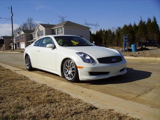

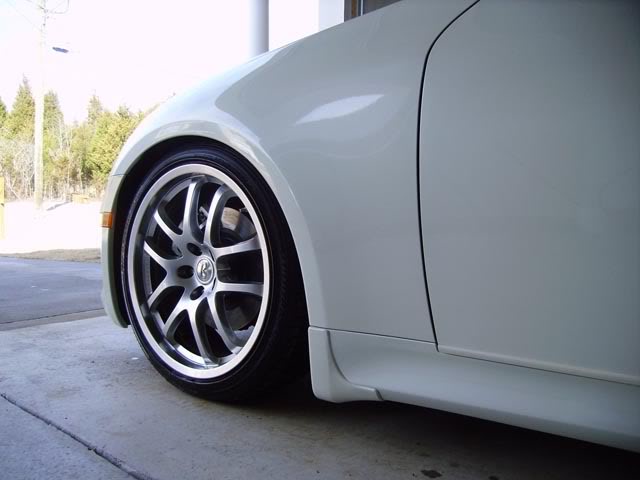

mmm...perfect drop in terms of oem wheels and springs...
member NVS_g35
springs: tanabe df210

Gimme. I've got the 19s with stock rubber. The white car looks slick, but could use some spacers IMO.
Old Feb 2, 2007 | 10:53 PM
Calvin's Avatar
Overglorified Altima
iTrader: (65)
Posts: 53,506
Likes: 187
From: Chicago
spacers, yeh...definitely.
but that drop is the perfect drop as far as springs go (imo)
