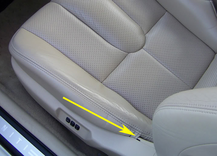

The faulty window regulator/motor has been a common problem for a lot of G35 owners. Mines went out without notice, just like yours, about 3 yrs into owning the car. I also had the bottom portion of the driver's side replaced because there was a little tear (factory recall). Good to hear everything was covered under warranty.

what year is your car ljn? and where was the tear? I might have the same issue

^ I have an 05 but since it's recall, it's still covered. The picture is from a newer model, I just found whatever was on the net. The arrow is the spot of the tear.

thats almost exactly where mine is, but its an 04...
the foam seat is sprinkling **** underneath the seat as well. any idea if the recall is for more than just the 05 models?
