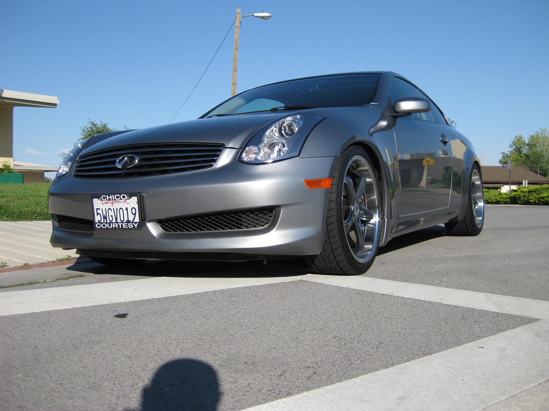

im wondering what camber kit to go with that's inexpensive? i have the eibach springs 1.1 front and 1.0 rear with 2753520's on thruxton 10's rear and 2453520's on front
also i think if i correct the negative camber in the rear that i will have to get the fenders rolled would running a 2853020 make this worse? any help would be great or comments on what would look better? here is a snap

i dont think you should change the tire size 275 is wide enough with the cars hight droped you already have negative camber @ the back. you can get that check at you alighnment shop. anything more then -1.5 degree will eat up the inner side of the tire. If you not into track days or high speed corners dont get it.
The car seems fine to me.
