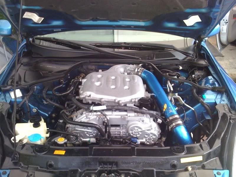

hey guys engine looks a bit boring to me and dirty lol whats the best way i can make it clean looking ( not from dirt lol ) but to hide wires or something i dunno , to much other then the engine to see anyone got ideas?

off the top of my head...
assuming you want to go the polished route, Sean can do the upper plenum, lower plenum, spacer, VTCs, timing cover, cam covers, throttle body, and a few other items. you could always paint or powdercoat these items as well.
these are a few of the things a few folks have done in the engine bay to start out:
EASY STUFF
- CLEAN EVERYTHING
- hood dampers & get rid of hood prop
- buy driver side fluid cover
- paint oil dipstick black
- tuck brake booster vacuum line (can hide it behind intake manifold)
- get rid of the A/C line bracket on driver's side
- paint coolant reservoir and power steering reservoirs
- get rid of windshield wiper fluid filler (put some blue tape over the reservoir and put the filler in your trunk)
- remove stickers from core support
- aftermarket fluid reservoir, radiator, and oil caps
MORE INVOLVED
- tuck side & main harnesses
- paint valve covers
- paint battery and brake fluid covers
- samco/venair coolant hoses (can do stainless steel if u swap radiators)
remove idler pulley
- swap out fluid reservoirs
- relocate fuel line
you should also reinstall your wheel well liner(s). that'll help keep things clean.
