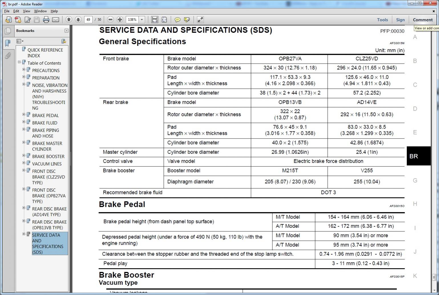

One thing no one has mentioned here is that the brake master cylinder and brake booster are both different on Brembo-equipped cars. No one swaps those, I'm guessing, but they should.
last time I did the swap to an '03 sedan and I confirmed with the dealer that those parts were the same.
The dealer is wrong, at least according to the FSM.
OPB27VA/OPB13VB = Brembo
CLZ25VD/AD14VE = standard brakes
Attached Thumbnails Put brembo brakes put on a 2005 g35??? HELP!!!-brake-parts.jpg
