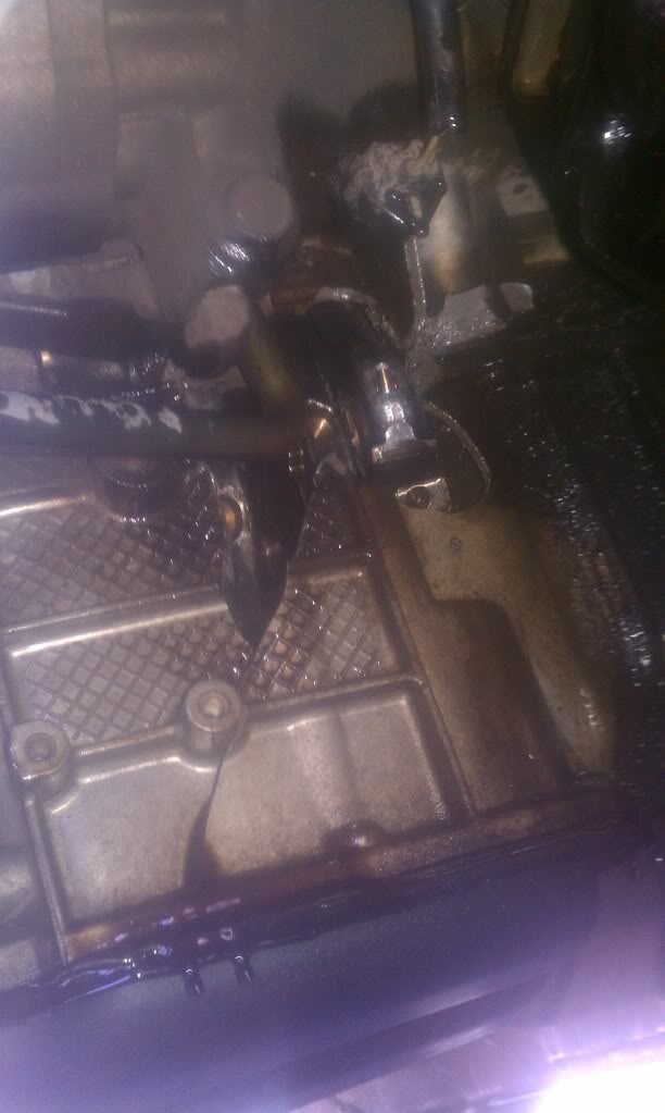

Old Jun 4, 2011 | 09:57 AM
smitty89's Avatar
Posts: 164
From: Kingman, AZ
She blew at 127,602 do to lack of oil put a rod through the block it was my bad for the most part but after pulling it apart I found out that she had some internal leaks and burning problems
