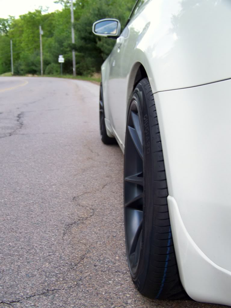

VQ Johnny's Avatar
Joined: Jan 2010
Posts: 860
Likes: 106
From: əloɥssɐɯ ʇuəpısəɹ
Originally Posted by Adil_G35
I should probably just wait for the +12 offsets to be in stock then.
Good idea, just so you know what your getting yourself into here's a pic of my +22 at stock height, now picture those sticking out almost a full inch further is how a 0 offset would look. Don't take it the wrong way I'm not bustin your stones, just trying to point you in the right direction, remember you can always go more aggressive with spacers, but if you get too aggressive with your offsets you're going to be stuck with it.
Old Jul 25, 2011 | 11:43 PM
Adil_G35's Avatar
Joined: Mar 2011
Posts: 1,260
Likes: 56
From: Houston, Tx
Yea i feel you man. I wanted the +12 but they said its out of stock and they have only +0. So i wanted to know what im getting myself into. Thanks for looking out
