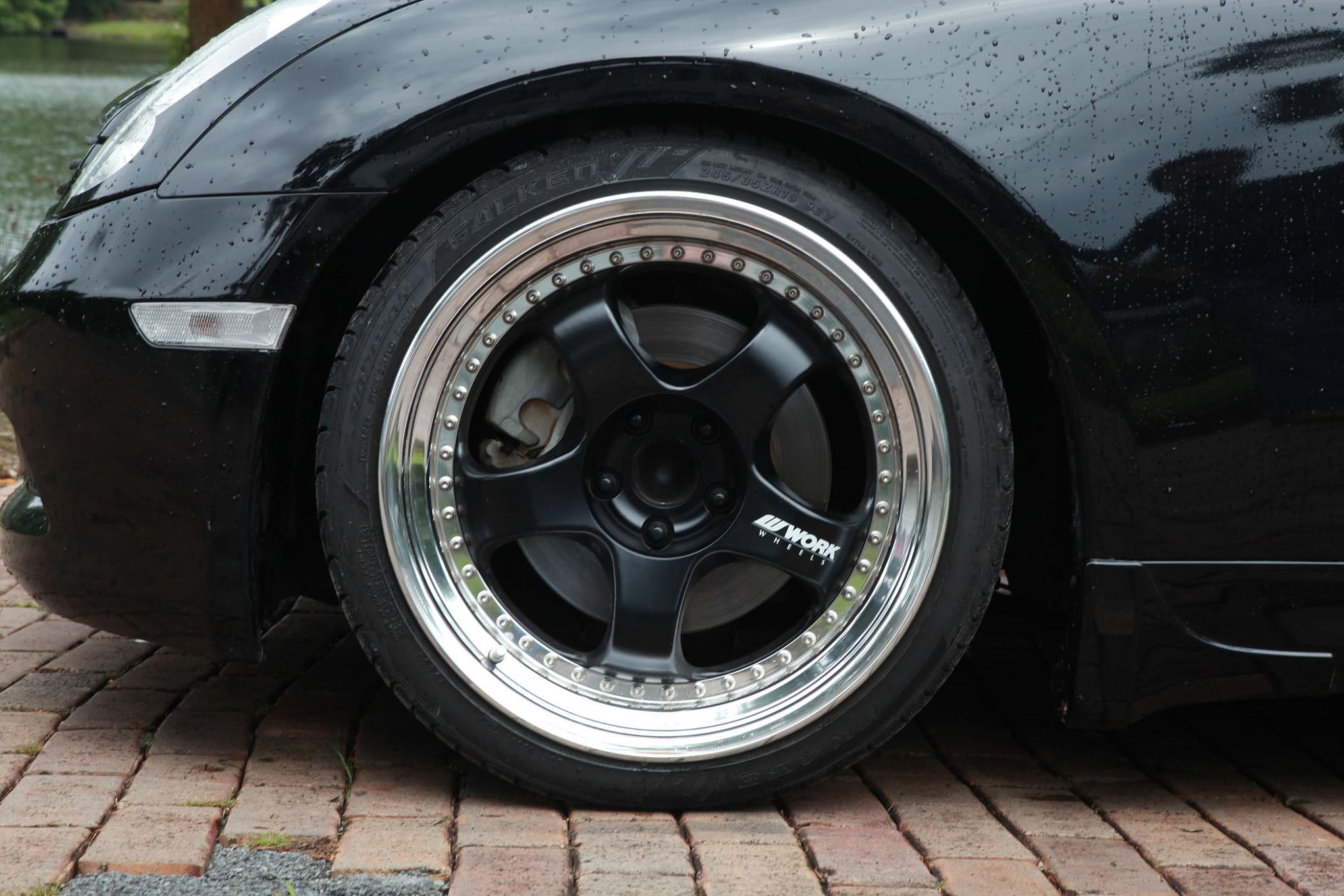

Hi and welcome to Driver.
I currently have SWIFT Sport Springs on my ride with the "Springmount" Mod done to her as well. Virtually no wheel gap whatsoever. Mine came with the rims but I believe you can nap some on eBay from $250-$320. Possibly even lower here at the Marketplace. It lowered the fronts about 1" and the backs close to .06. Add in the Springmount Mod and the back was close to 1.5 I believe. A nice drop overall for a DD. Would love to get coilovers but this will suffice right now. Good luck!!!!
Don't know why I can't seem to get these pics to resize automatically but click on it to see the full-sized image.

Nice set up messinex...by the way what helped you decide to go with the swift springs?
I think the swift spring will be the best springs as long as you get the linear type not the progressive in my opinion...but most likely won't find them to cheap good luck OP...

I purchased my WORK Meister's from Mark @ Ravspec. At the time, he was throwing in free SWIFT springs with every order. At first, I wanted the drop a little more so I did the "Springmount" Mod to lower the rear another inch or so. Thanks for the props on the set-up.
