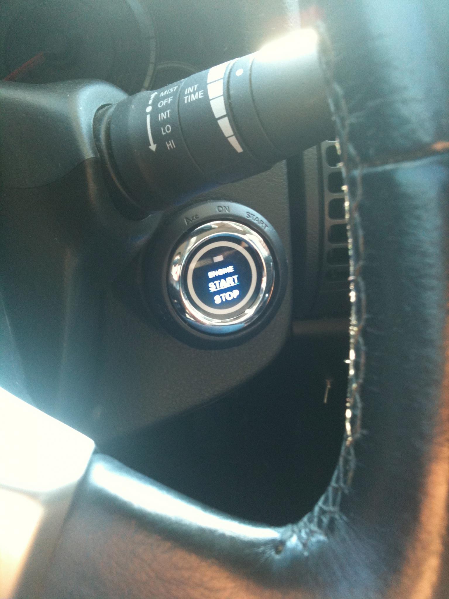

Old Oct 6, 2011 | 05:15 PM
  #27
hamzafraj's Avatar
Posts: 201
From: Seattle/Chicago/Indy
ok so after some cutting and grinding, here is what I came up with
Old Oct 6, 2011 | 05:35 PM
  #28
threatcon07's Avatar
iTrader: (20)
Joined: Feb 2006
Posts: 1,334
Likes: 22
It looks OEM now! good job!
