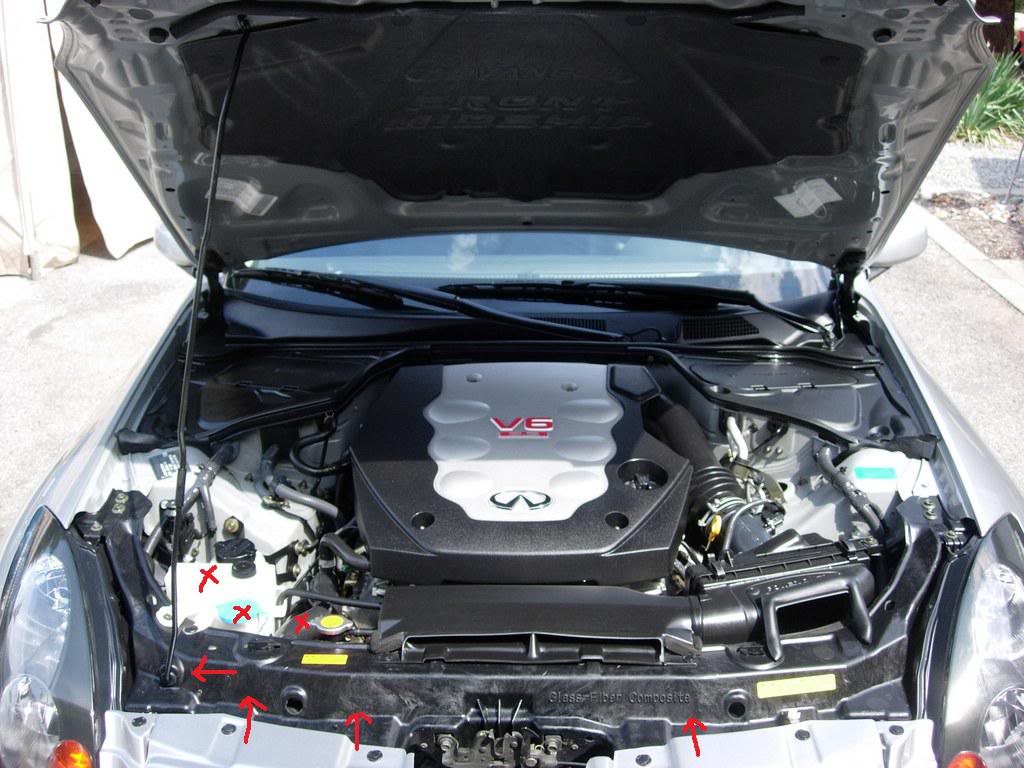

I need to buy the parts thats indicated x in the picture and also where do i get the thing with arrows that black kinda of guard that goes along the front mines broke in half.... heres a picture of the stuff thats missing of the things that are marked red anyone know where i can get those i'd appericate the help.

The part you have marked with red arrows (that says "Glass-Fiber Composite") is called the Radiator Support. It's $335 new from everythinginfiniti.com
Might get lucky at a junkyard, but most of the time a G gets totaled is because it was hit in the front.
Also, if you rad support is broke in half, I'd be worried about a bent frame (ie: the replacement won't line up with the mounting holes on the body). A body shop should be able to bend everything back to square if needed though.

I have an extra coolant overflow tank and washer fluid filler neck that are painted black if you're interested. Only issue is the don't have caps. PM me if you want them.

changing the core radiator support is.....fun... lol

is it really? i mean i swapped headlights out before observing it i first have to see if the frame is bent before putting a new one on....

also fyi, the sedan and coupe are same part. but make sure you get the one for g35 and not 37, the link I just had was incorrect, corrected to the g35 one.

the support is kind of a huge bitoch to do. when you put it back on though, make sure you line up the bottom to the radiator plugs first then slip it over. i made the mistake of starting at like 5 and by the time i finished it was 11pm and i found like 4 screws that ended up not getting put back lolol.
