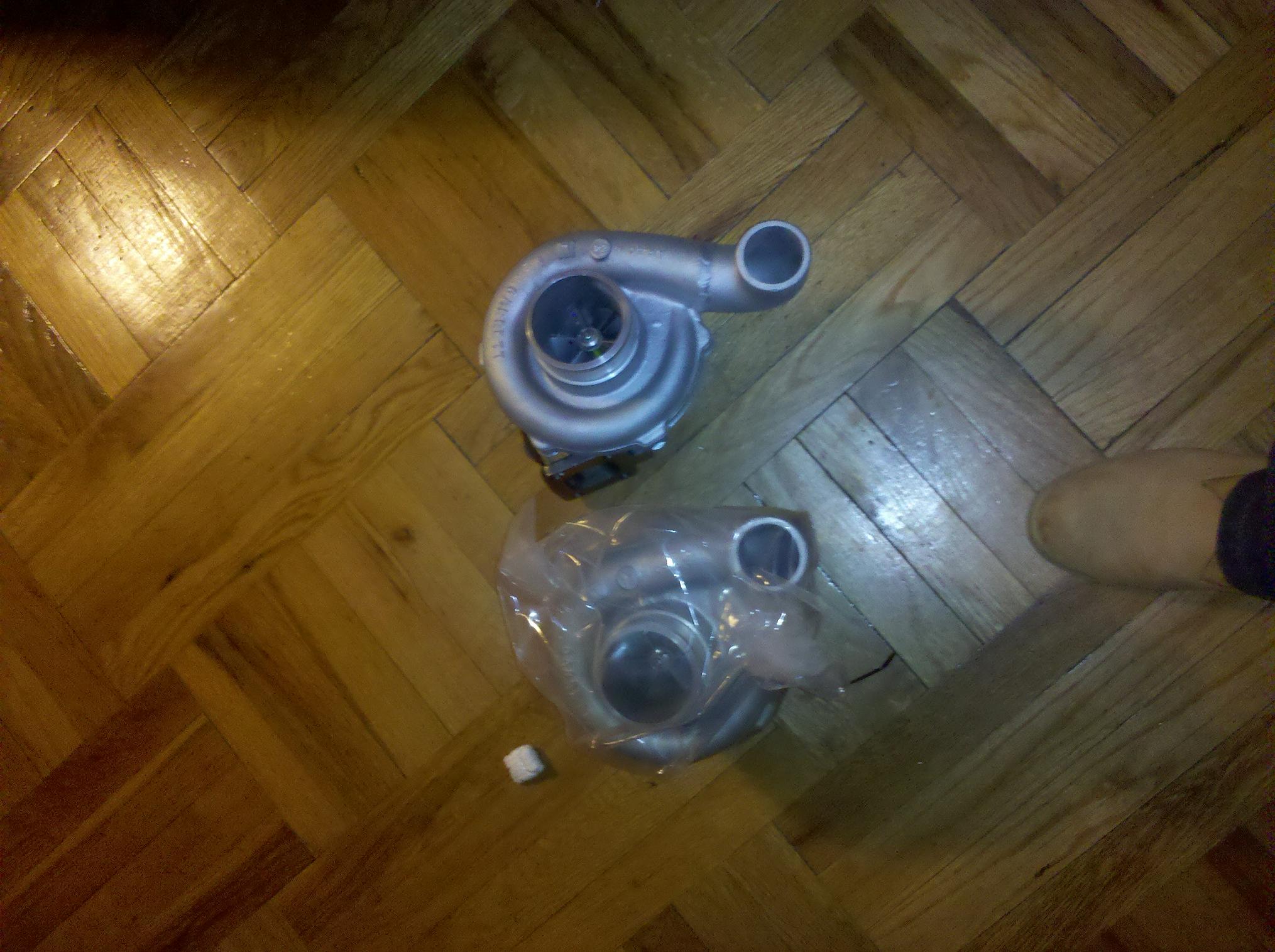

I posted some pics of my car and the manifolds and gt30s
Attached Thumbnails Twin turbo adventure-img_20110117_155039.jpg   Twin turbo adventure-img_20111015_113852.jpg   Twin turbo adventure-img_20111018_192639.jpg

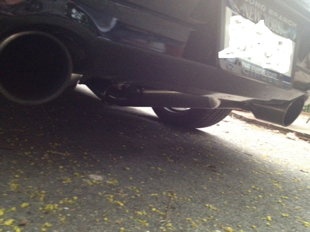

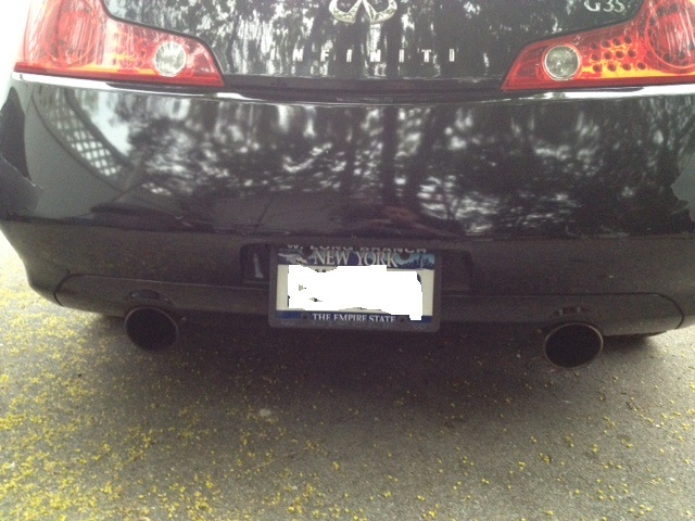

So I finally got her!! I took some quick pics ( iphone quality and its getting dark so you know theyll be awesome). The twin disc pedal feel isnt as bad as i thought it was going to be, it takes a little getting used to but if this was my DD I could definitely deal with it. The exhaust sounds amazing, anyone thinking about the motordyne v2 thumbs up from me. Ive got to get an alignment so Ill try and get some pics from under the car then. I raised the front half an inch and still scrape my driveway so Ive got to do the ol take it an angle, block traffic and go 1mph. Dont judge me on the body, it needs a paint job and I blew all my money on everything else. One of the pics you can kind of make out the air filter tucked behind the bumper.

I see your exhaust tips are close to the rear bumper, have you noticed any melting of the rear valance?
