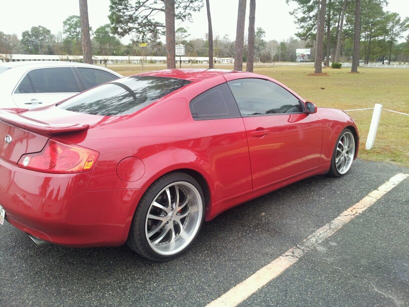

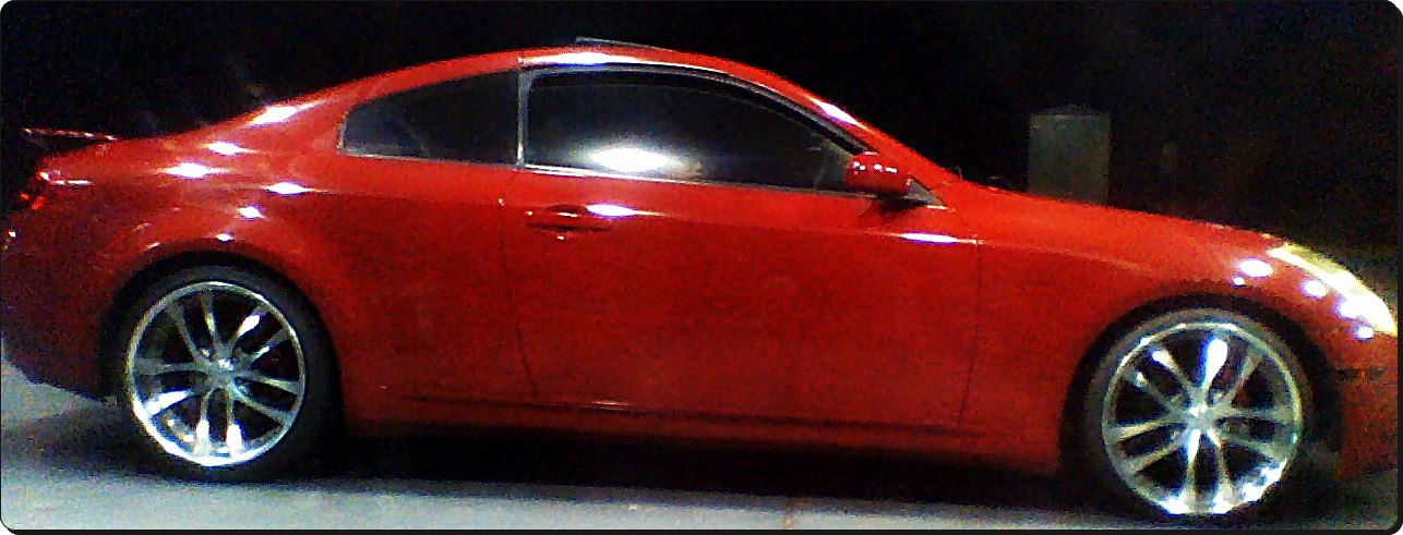

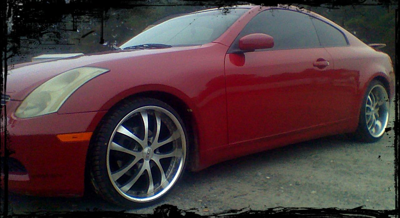

its not illegal in Ga. we dont have no emissions law, im going to go with test pipes i think ive seen cars with ART pipes mod and theres no difference at all dont waste your $$$ on them, Im pretty sure i have a bad cat anyway the gas smell in my car is pretty rough sometimes, So im gonna just replace them with test pipes and see how that works, Test pipes worked great on my STi but that was a turbo car
