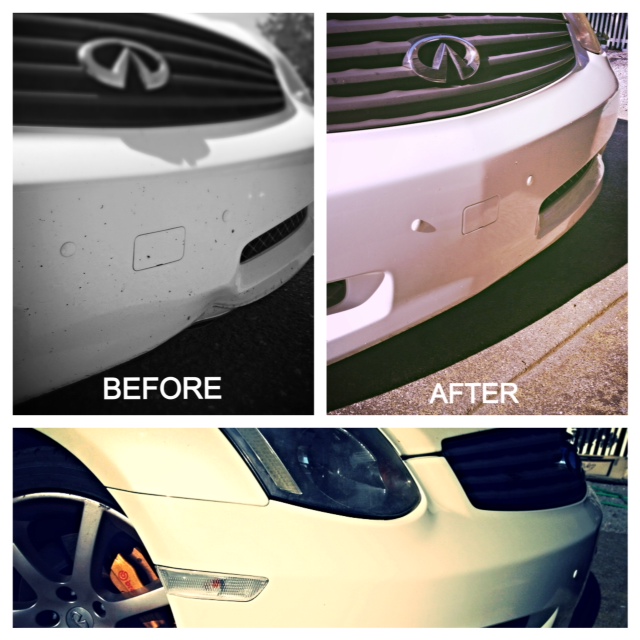

Haha I am here and thank you everyone for the help. I took off my bumper today thanks to youtube and heated it up with a hairdryer and popped out the dent. Looks a lot better but you can still tell it was there. I ordered clear corners since the bumper is off so I have to wait a couple days to put it back on. Will post pics

I thought corner lights could be removed easily without having to take the bumper off... I was going to add smoked corners next. They should be "pop and play"

You do not need to have the bumper off to replace the corners. They do not require any tools and pop right out. Go ahead and put your bumper back on and put your existing corners back on until the clears arrive.

Thanks guys for the help, much appreciated. Officially finished and added the clear corners. Looks good.

What did you end up doing to fix this?

Took off the bumper via youtube, heated it up with a hairdryer, and with a little push, it popped back into place. After, I gave the bumper a much needed wash, stuck the clear corners on and put it back on the g. Unfortunately, there still is a little indent that isn't truly noticeable unless you run your hand across it but it bothers the hell out of me.

Add a front splitter and kiss that imperfection goodbye.
