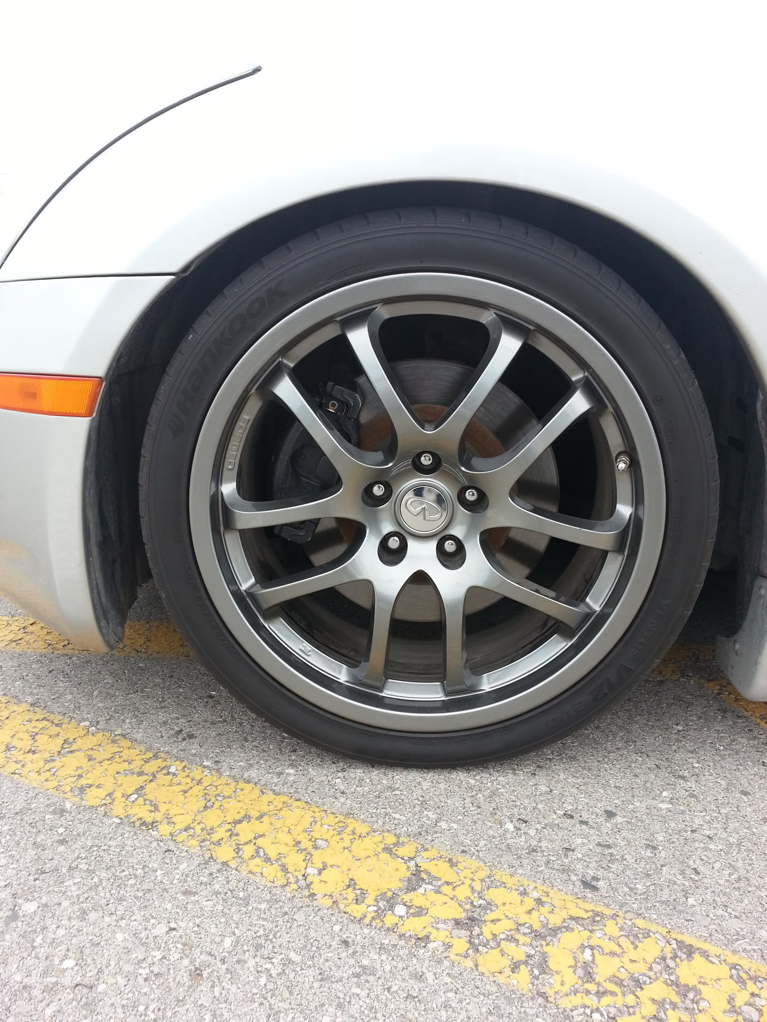

Here's ope pic of the final product...I'll take some better ones of my rides soon.
I thought about it for the longest time also...wanted to be reasonably sure it would work before I invested $100 and a night of my time to try it out.
Made sense it would work, as the Akebonos bolt on direct to the V36. It's really close in some spots..I was expecting it and was prepared to get out the dremel or machine parts. Good thing it was actually a pretty painless swap.
Also, rears bolted right on, as would the Akebonos.
I think it's a great upgrade, do it up if you have a set! And yeah, I did mean the V36 sedan is better than (at least my) coupe.
